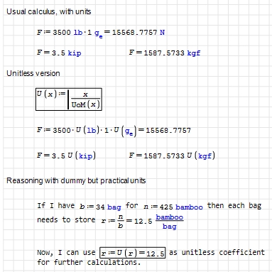

For me units have 2 purposes:
1. Getting quickly understandable numbers
2. Checking errors (unit consistency)
Hi. I agree. Here, a way to get that. Also, notice that you can use almost any other unicode symbol for U(x), or 'U(x), i.e. U in blue.
DummyUnits.sm (9.65 KiB)已下载 1237 次。

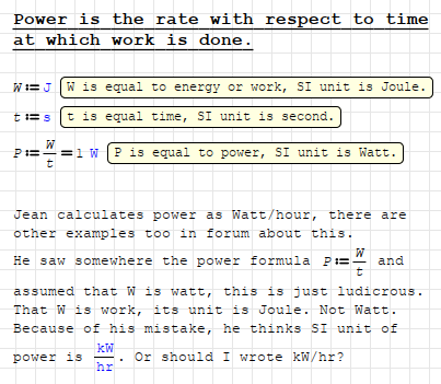

And sometimes that numbers tend to make serious mistakes, like that kW/hr pump power calculation of his.
Not even a typo, he divided 1hr (3600s) to g.e (9.8), found 367 and used it in that abomination.
I have never seen that kW/hr usage anywhere, but interestingly his pump power results have it.
It should even be kW, not even kW*hr. What will be benefit of pump electrical consumption calculation?

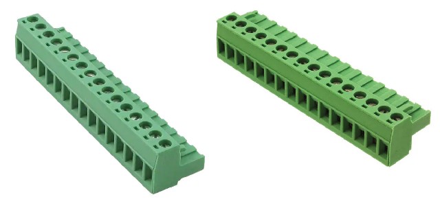

Here is how dumb-ass maintaining support for imperial is... these two connectors look the same but are incompatible (5mm pitch versus 5.08mm pitch). The outside pins on the imperial compatible (0.2" ) part are 1.2mm further apart.
Connectors with less poles can kind-of work...
This type of thing looks like an industrial (process control even...) accident waiting to happen
