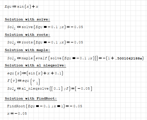

Hallo guys,
i have an simple qeustion:
How can i numerical solve an equation with a solver block like in mathcad.
An equation which is transzentent for example
for example:
sin(x) + x = Y --> solve for x
and how can i solve an equation when equation is not transzentent?
like in mathcad with a solver block area....?
thank you br Stefan
#2 已发布: 2022/4/29 06:19:37
1,558个赞,共1,868个帖子。
Various examples are possible.
Mathcad Block. FindRoot example.sm (4.81 KiB)已下载 1317 次。

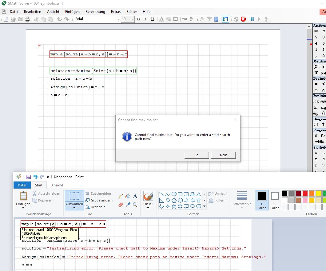

Thank you but i have a problem i downloaded the latest version
i downloaded maxima plugin and others but i do get a failure when opening your file see attached picture
There is a file missing:
cmaple.exe / maxima.bat missing
What can i do ?

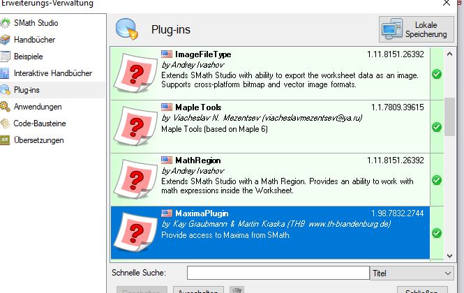

however smath says maxima plugin is installed:
Thank you br Stefan

It seems your mentioned firewall settings prevented proper installation of Maple plugin.
Usually SMath plugins are saved under this path in Windows 10.
C:\Users\/AppData/Roaming/SMath/extensions/plugins/
I can copy my plugins directory on Windows partition and upload it for you to download and copy/overwrite.
But it won't be a convenient way to install plugins. Set an exception to your firewall for SMath downloads.
Maxima is another subject, plugin seems installed but you will need Maxima software to make it work.
Latest version can be downloaded and installed from link below.
https://netix.dl.sourceforge.net/project/maxima/Maxima-Windows/5.46.0-Windows/maxima-5.46.0-win64.exe
You also have to set the path for Maxima.bat under Insert>Maxima control windows>Settings menu.
