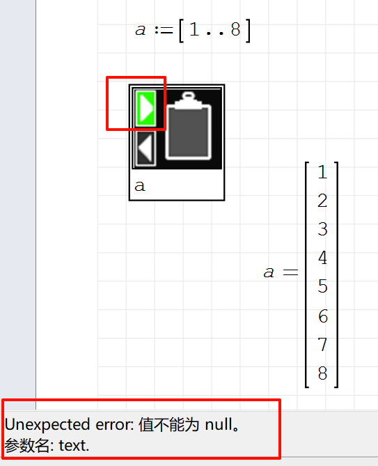

hi Davide
glad to find this extension ,but it seems dont work when export value
for export variable value , click Right-pointing triangle then it comes to an error , nothing copied to clipboard
for import value to variable , click left-pointing triangle then it works as expect
I'm not sure if the problem is on my end or with the plugin.

1,443个赞,共2,936个帖子。
Hello, I'll check it, at first glance seems an error plugin-side.

hi Davide
Found the issue, fixed code uploaded in the SVN. Can't release the plugin because (I think) there is an issue server side on the relase manager.
Dear David,
The finding was caused by new project format. Andrey performed necessary adjustments. You may finish your work now.

1,443个赞,共2,936个帖子。
Thank you very much!
Plugin updated
