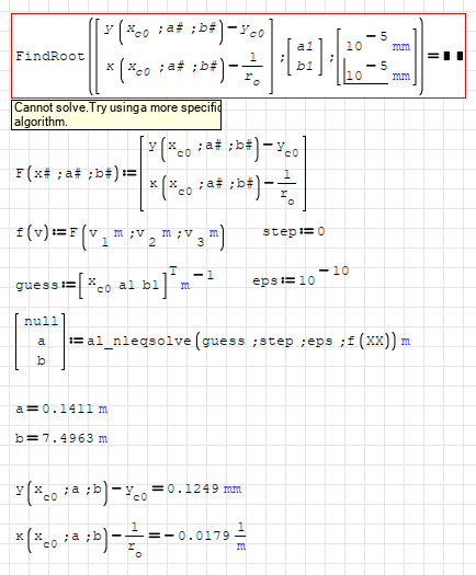

#1 Posted: 2023/10/7 16:31:52
Valery Ochkov
Valery Ochkov
66 likes in 682 posts.
CP-Cyrcle.sm (24.37 KiB) downloaded 1129 time(s).

#4 Posted: 2023/10/8 13:51:08
597 likes in 1,377 posts.
You don't have to eliminate units.
There are tricks to use them in solvers.
This is the best I could get.
Maybe a pro user can help you better.
roots() supports multiple argument btw.
Your equations has derivative.
Possibly reason of error by conventional solvers.
roots(), FindRoot(), solve() mostly doesn't like it.
CP-Cyrcle_solved.sm (32.37 KiB) downloaded 1134 time(s).

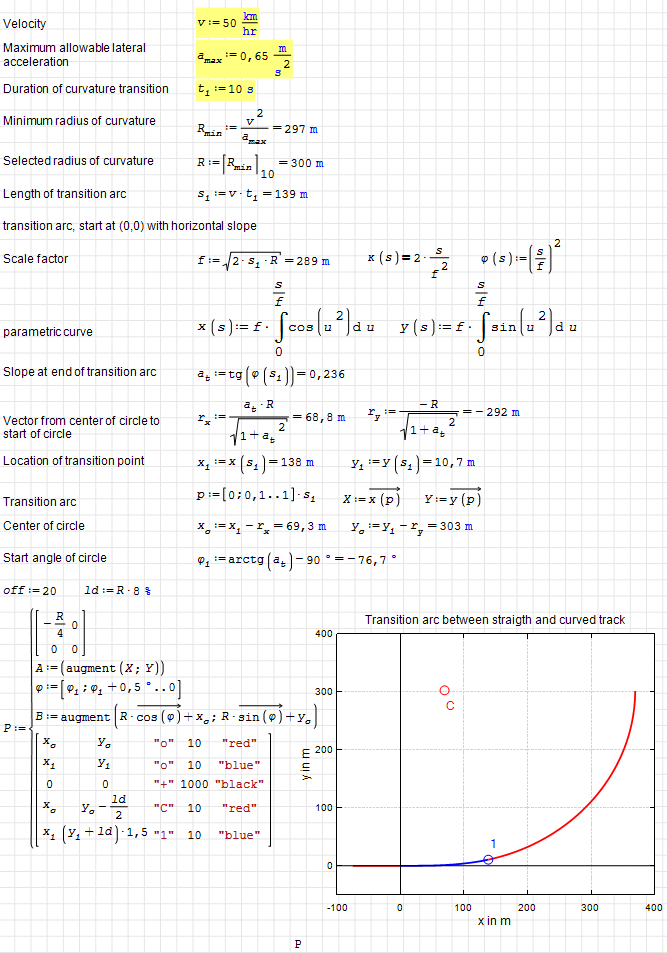

#5 Posted: 2023/10/9 05:44:58
1,353 likes in 2,264 posts.
This is a version without solving equations. The curvature is known as a function of the path length.
02 Ubergangsbogen.sm (80.24 KiB) downloaded 1183 time(s).
Valery Ochkov 2023/10/9 05:52:00, Oscar Campo 2023/10/9 07:39:00
