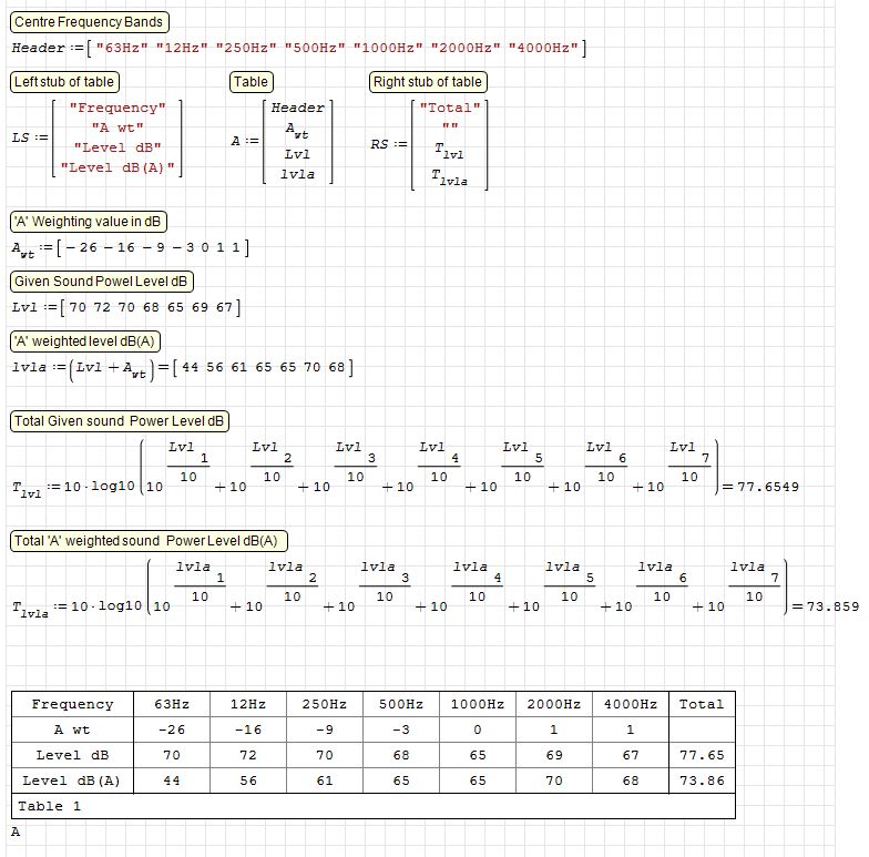

Hi All,
I am trying to work out the 'A' weighting values for sound levels, I have the calculation working, but I would like to simplify the total power levels, by either summation or a loop function. I know how to use summation, but cant get it to work on this.
acoustics 1.sm (17.98 KiB) downloaded 917 time(s).

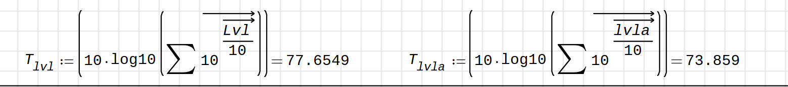

How's this? Using vectorize() function to apply operations to each element in a matrix.
Show Spoiler
acoustics_lyles.sm (14.86 KiB) downloaded 899 time(s).

Hi Alyles,
That was exactly what i was looking for thank you.

alyles,
maybe there's an excess of vectorization
frapuano 2019/10/20 16:37:00, Arie 2019/10/20 16:48:00
