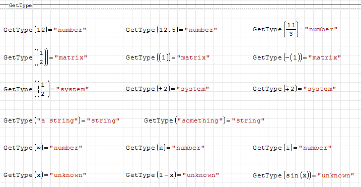

I know this is old thread, but was IsMatrix ever implemented or similar functionality?
WroteWroteI will add IsMatrix function to the new version of SMath Studio.
If you download the plugin Custom Functions, you can use GetType()
![2016-03-23 19_57_02-SMath Studio Desktop - [CustomFunctions_examples.sm_].png](/zh-Hans-CN/files/Download/GYV75Q/2016-03-23-19_57_02-SMath-Studio-Desktop---[CustomFunctions_examples.sm_].png)

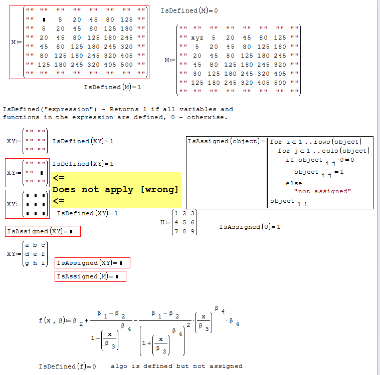

Jean,
when an error is thrown the result is not stored -> this means that in SMath Studio is not possible to define a matrix with empty placeholders -> your IsAssigned will never works under these assumptions...
Hence, also IsDefined() works correctly because the first assignment of XY is not overwritten nor deleted, hence it is still in memory (XY is defined in the worksheet memory).
![2016-03-23 22_44_42-SMath Studio Desktop - [Page1_].png](/zh-Hans-CN/files/Download/QhVFYv/2016-03-23-22_44_42-SMath-Studio-Desktop---[Page1_].png)
BTW, you shouldn't use "object" as target of the function [el(object,i,j):whatever], you have to use a brand new matrix defined inside the function (because the pass-by-reference, if you use an argument as target of some calculation you are modifying it)
