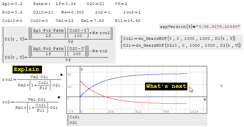

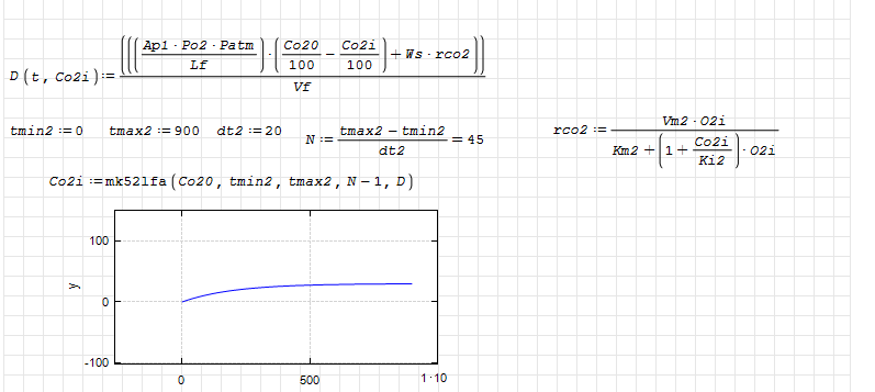

#2 已发布: 2020/11/23 08:58:31
1,558个赞,共1,868个帖子。
You need to be more careful about the variables and their order in the document.

#4 已发布: 2020/11/23 09:08:08
1,558个赞,共1,868个帖子。
Now I try to fix it and, in general, to be more ordered.
If you describe the original system, it becomes clearer what you want to get.

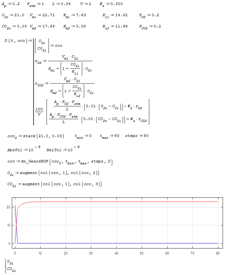

#8 已发布: 2020/11/23 12:18:13
983个赞,共6,866个帖子。
#9 已发布: 2020/11/23 12:26:42
francesco88
francesco88
1个赞,共34个帖子。
Really thank you for this correction, seems great!
g Ok, definitely I have to study hard and better how to use smath and repay the community.
Veniamo da molto lontano e andiamo molto lontano! Palmiro Togliatti

1,558个赞,共1,868个帖子。
#11 已发布: 2020/11/23 12:49:50

#12 已发布: 2020/11/23 15:31:15
983个赞,共6,866个帖子。
Now I work a little on this thing and we will see what progress I'm able to do.
AbsTol, RelTol is very specific w/o project application(s)
The attached is suggestive of exploring more.
ODE GearsBDF Undocumented.sm (18.75 KiB)已下载 1159 次。

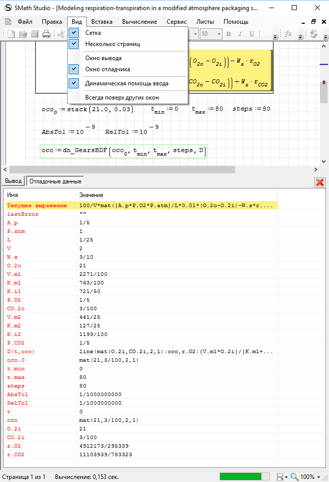

#15 已发布: 2020/11/23 23:55:07
1,558个赞,共1,868个帖子。
You can set breakpoint on line in D(t,oco) and you will see how values changed.

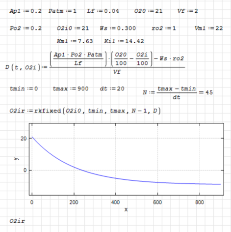

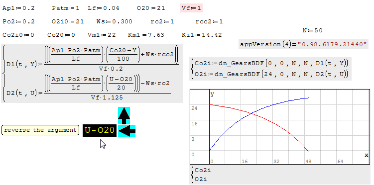

#16 已发布: 2020/11/24 07:24:14
francesco88
francesco88
1个赞,共34个帖子。
Yes, I have to study a little bit about this function of smath...to be honest, all the functions!
In general, there is something that doesn't work properly, because the chart describes the depleting and the increment almost linear until the O2 don't reach 0. After that point the CO2 increment start to being described in a "realistic way
I mean, I'm expecting to see something like that (the thick blue lines)
#17 已发布: 2020/11/24 08:03:32
1,558个赞,共1,868个帖子。
You need to set real values for all variables. It is not entirely clear from the article what values to use. I can't help here, because I'm not familiar with this task.
I have demonstrated how you can solve this problem. Now you just need to correctly describe it in terms of the program. I wish you success.

#19 已发布: 2020/11/24 11:06:59
983个赞,共6,866个帖子。
Like this ??? ... freak parameters at will .
#20 已发布: 2020/11/24 11:36:51
983个赞,共6,866个帖子。
... up to You the expert !
Prova modello permeabilita.sm (129.71 KiB)已下载 1224 次。
