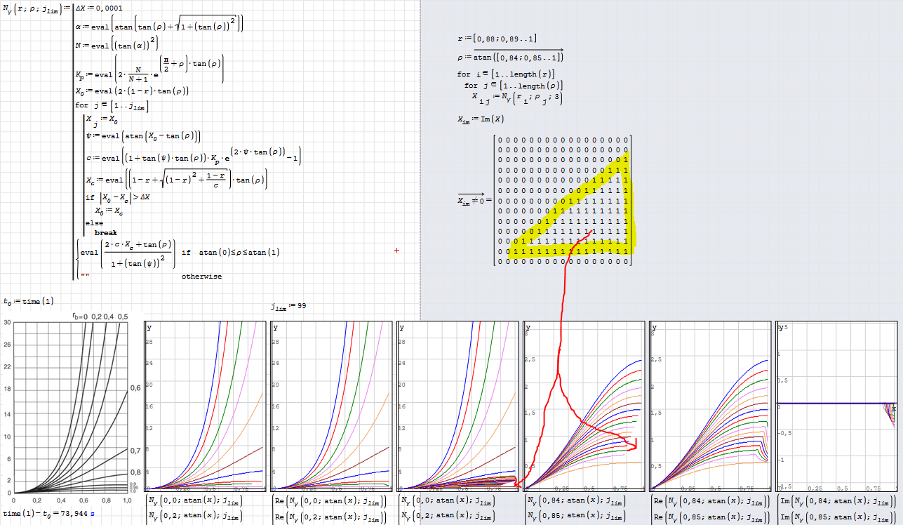

The plots of N.γ(0.9,atan(x)) and N.γ(0.95,atan(x)) has an odd shape when they approach x=1. It turns out there are some complex solutions in this area.
Is there anything to be done about this, to make the graph closer resemble the diagram?
This is a good observation, I did catch it but didn't mention.
Yes the system generates some complex values, can't track it back
in the generating algo. Will have another look.
The atan(,) from numerical libraries does not generate complex.
That's why you had no plot initially, complex blinds the Quick plot.

Another interesting observation is that j.lim in the even Numbers generates values in the areas mentiod that are far too big, while odd j.lims generate conservatively small values.

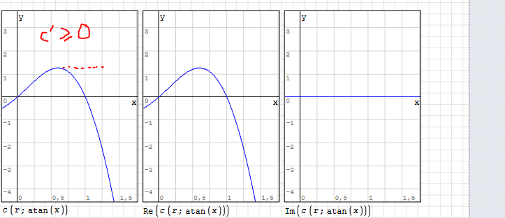

Take a look at this sheet, where every factor of the equation has been ploted separately.
It seems the complex numbers starts with X.c before the iterations start, due to c going negative.
EDIT: It seems in order to produce a plot similar to that of the diagram, dc/dx can not be allowed to be negative. How would I be able to manipulate this?

From your last report, you are right and wrong.
In many more projects, residuals complex have been observed
where the maths do not generate complex. The numerical Smath
engine is in cause. In other applications Smath 32 bits is too granular.
Your project is a two time constants XFR [Transfer Function],
associated wrt the composite process gain Kp. That is much different
than XFR in Process Control Techniques. Maybe the model is ill posed.
In the mean time, by pushing j 1..99 we get a much better recovery.

JMG - great tip to put eval() on all the lines inside the function, sped up the computation considerably, far beyond just right clicking and choosing numeric evaluation.
I think unless someone on the forum can find a way to differentiate c, I will stop pursuing this further.
I have attached a new sheet with my final findings of this function. In my furter application of N.gamma i will have the function output only real values of the solution, and use deltaX = 0,0001 and j.lim = 99.

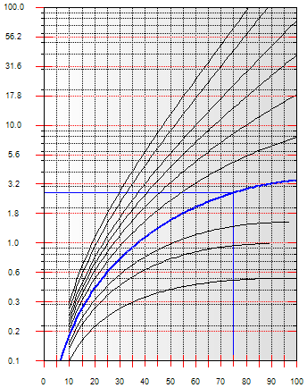

Thanks for the details. As is, the project is complete.
You can create an interpolated blue track trace, read Nγ on the plot.
I'm not completely happy of the Y log, however immaterial for application.
Thanks Hanski for enriching the Smath Community
Jean ... last brew attached.
The whole business of ploting the function is just for documentation purposes, to make sure the function is correct (compared to the referenced diagrams).
In practical application, only the function will be used.
I think the whole problems is ill posed, as you suggested earlier, as evidenced by the complex results. I have made a modification to the function to combat this in my final version of this function.
