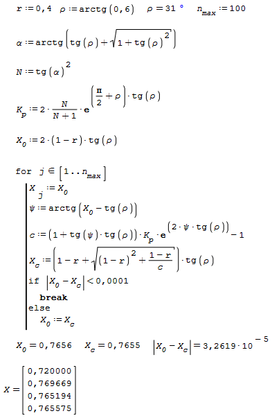

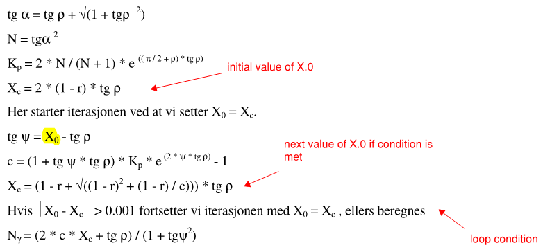

Hi.
I need help with a iterative calculation. This is my first time trying to build a iterative loop in SMath.
I need to calculate a coefficient that can only be calculated when the difference between X.0 and X.c is below a limit.
I am trying to solve this as a function of r and rho.
Can someone help me get started on how to formulate the iteration?
problem.sm (11.9 KiB)已下载 1175 次。
Best regards,
#2 已发布: 2020/10/2 14:47:52
1,362个赞,共2,276个帖子。
problem_Kr.sm (10.77 KiB)已下载 1266 次。

#3 已发布: 2020/10/2 15:31:50
hanskl
hanskl
7个赞,共158个帖子。
Thank you for your suggestion Martin!
I need the output X to be a function of r and rho. Is that possible?
Some random questions...
1. why do you use arctg instead of atan?
2. does the iterative process have to be wrapped into a for loop where you need to give it a range, and ultimately an upper boundry (n.max)?
#4 已发布: 2020/10/2 16:58:52
1,362个赞,共2,276个帖子。
0. I think you would need to wrap the full procedure into a function of r and rho with X as return value. Alternatively, you might come up with a recursive definition of the procedure.
1. It is just the setting world versus european style for functions. It is the same function, just displayed according to the GUI settings.
2. the for loop just came in handy for generating the indices for storage of iteration history. You could use while 1 as well. I also thought it was a good idea to have an upper limit for the iterations in case the algorithm might diverge.

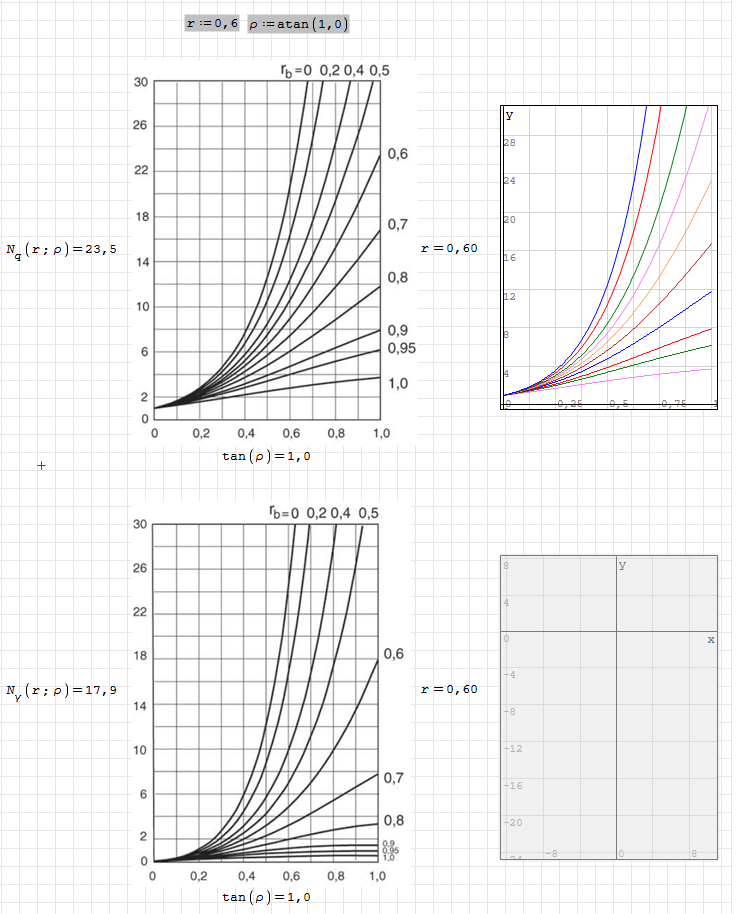

#7 已发布: 2020/10/2 19:53:46
hanskl
hanskl
7个赞,共158个帖子。
Sorry, don't understand.
If you want to see the evolution of the solution, use a while loop,
SQRT(x) in Samples is a good example.
Visit Golden ratio as well.
problem_Kr Plot What.sm (17.85 KiB)已下载 1246 次。
Hi Jean,
Thanks for the sample.
I think I got my calculation working now with (a lot) of help from Martin.
I cant plot N.gamma(r, rho) because it obviously takes an enormous amount of computational power.
However, the formulas seem to return the correct value when you compare to the diagrams in this sheet (the benchmark for my calculation).
PS. Is there some way to speed up the calculation of N.gamma? For some values of r and rho it can take Almost a minute to compute.
Cheers
problem_solved.sm (511.22 KiB)已下载 1199 次。
#8 已发布: 2020/10/2 21:02:57
983个赞,共6,866个帖子。
Get a quick insight ... that you can mesh finer.
problem_solved More Insight.sm (517.45 KiB)已下载 1207 次。

The functions calculate soil bearing capacity factors for drained conditions. N.q is used internationally, but N.gamma is according to Norwegian recommendations.
Cheers.

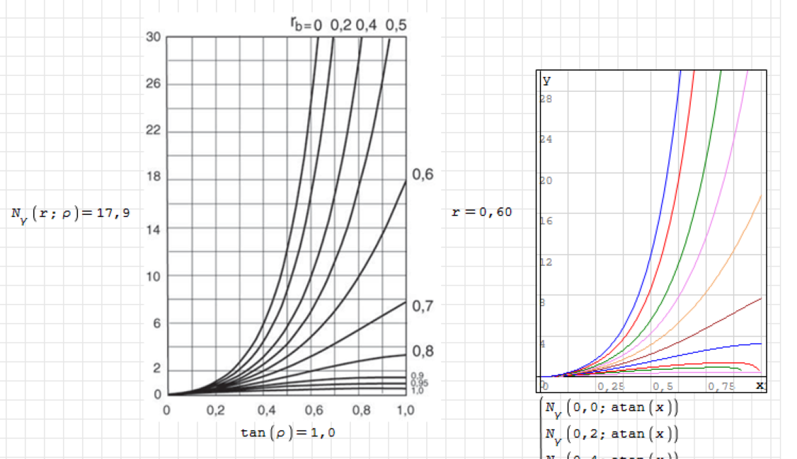

#20 已发布: 2020/10/4 13:51:31
hanskl
hanskl
7个赞,共158个帖子。
I have tinkered a bit because there seems to be a mismatch between my graph and the diagram for some values of r and rho.
The plots of N.γ(0.9,atan(x)) and N.γ(0.95,atan(x)) has an odd shape when they approach x=1. It turns out there are some complex solutions in this area.
Is there anything to be done about this, to make the graph closer resemble the diagram?
Cheers
problem_complex.sm (260.13 KiB)已下载 1203 次。
