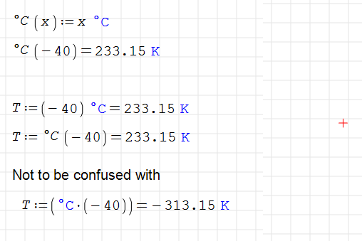

This is not a bug, this is how SMath works.
You have to use delta temperatures for that kind of calculations.
Unfortunately there is no easier way.
If you really need to calculate without delta temperatures,
You can use a custom equation/function like this.
