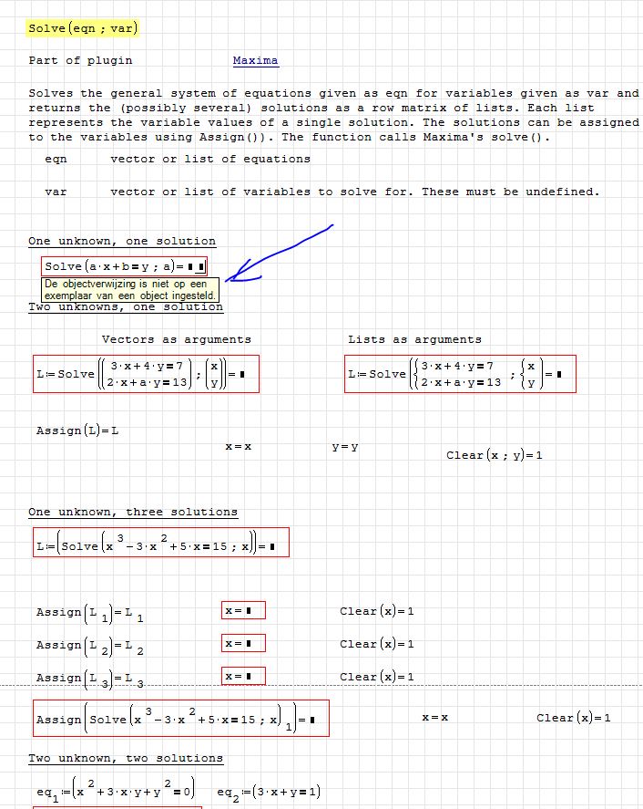

Many Thanks for the help sofar. I downloaded v14 + maxima en try to use the solve function, but I got the message as displayed in the enclosed file:
Translation of Dutch message: The reference of the object is not adjusted to an item of the object
What can be the problem ?
Another question: the solve option under the Calculation tab is grayed out. It seems I can not use this solve option. What can be the point ??

What is v14? I recommend to use the latest nightly build of SMath and Maxima, see http://en.smath.info/forum/yaf_postsm11095_Maxima-Plugin.aspx#post11095.

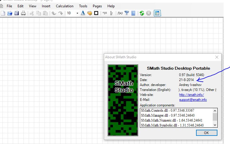

I use version 14 as is visible in :
I use windows 10 . Can that be the problem.
Do I have to do some installation settings to get maxima running ?
