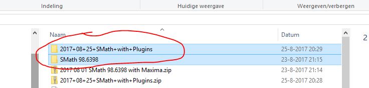

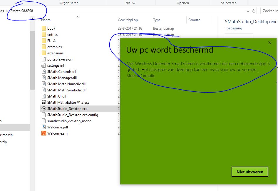

The only change I did to the executable was to set the 32 bit flag which is required for the Mathcad user library interface to work (Steamtables and Special math functions libs, userefi plugin). If you don't need this, then replace the executable in the portable distribution by the one in the LINUX version (yes, even if you are under win).
If that doesn't work you can still try the installation procedure described in http://en.smath.info/forum/yaf_postst2078_Maxima-Plugin.aspx. This exclusively uses original installers.
