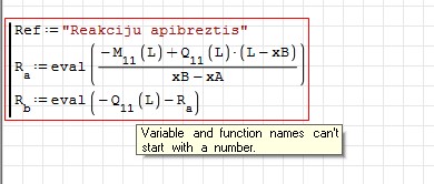

Hello.
This is very nice. I am civil ingenieer & I will use it. Thanks.
However it is dangerous to use the function x>Lf.
I found it out in my own beam programming.
When changing direction of concetrated forces, the graph of shearing force has to jump once up & once down.
And for the following input it does not!
It seems to me, the function x>Lf does not work correctly each time.
Regards Olik

Olik, try to change x>Lf to eval(x>Lf).
Thank you, kmihaylovich, the file is corrected.
Regards,Ber7
Regards,Ber7
Thank you! This is already fixed and will work correctly even without eval function into the next SMath Studio release.
