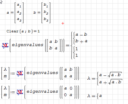

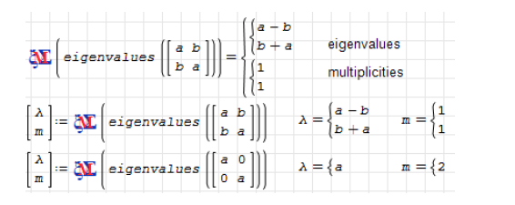

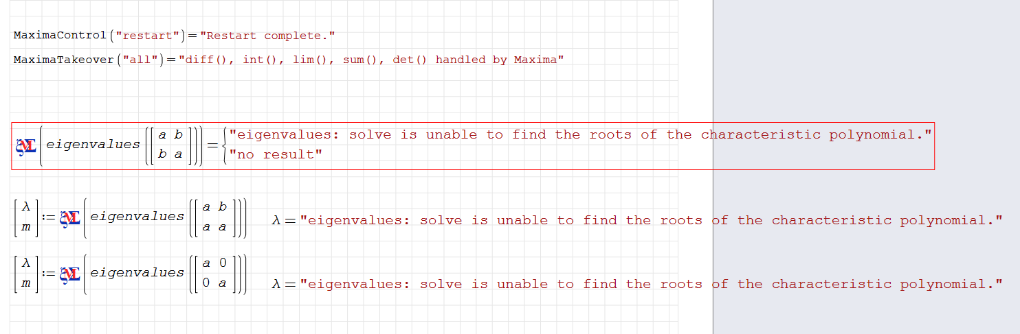

SMath Forum SMath Studio Questions eigenvalues error 1 Pages (2 items) eigenvalues error - Messages Go to last post #1 Posted: 2023/12/11 17:03:30 soomoon 1 likes in 40 posts. Group: User i'm studying SMath with Maxima (written by Dr. Kraska)but i did not get the result.my result is this.smath with maxima.sm (94.66 KiB) downloaded 1140 time(s).thank you in advance #2 Posted: 2023/12/11 23:27:17 Martin Kraska 1,353 likes in 2,264 posts. Group: Moderator You have to clear the values of a and b. These must be scalar variables, in your sheet these are vectors. Technische Mechanik mit SMath Studio: https://link.springer.com/book/10.1007/978-3-658-50592-9 1 users liked this postsergio 2023/12/12 00:59:00 1 Pages (2 items) New Posts No New Posts
