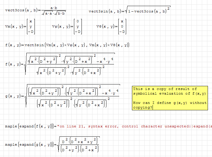

Simple question: how to assign a symbol to the result of symbolical evaluation? Sorry have not found the answer.
E.g. I have some function f(x).
I want to assign another function g(x) to the result of symbolical evaluation of df(x)/dx.
If I assign g(x) to df(x)/dx and make symbolical evaluation, I get correct result, but g(x) is still assigned to df(x)/dx.
Of course, I can symbolically evaluate df(x)/dx and copy the result to the definition of g(x), but then g(x) will not change if the function f(x) changes.

testassign.sm (14.53 KiB)已下载 1215 次。
Sorry, have not found the answer. Attached is a sample with two functions f(x,y) and g(x,y).
In the sample I have just copied the result of symbolical evaluation of f(x,y) to g(x,y). How to perform this assignment directly? I need g(x,y) to be updated if input vectors change.
Easy to see that symbolical evaluation does not change f(x,y). Maple can undestand g(x,y) but not f(x,y).

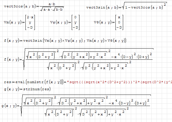

This works.
testassign_Kr.sm (17.97 KiB)已下载 1179 次。
avanturist 2017/5/5 14:48:00

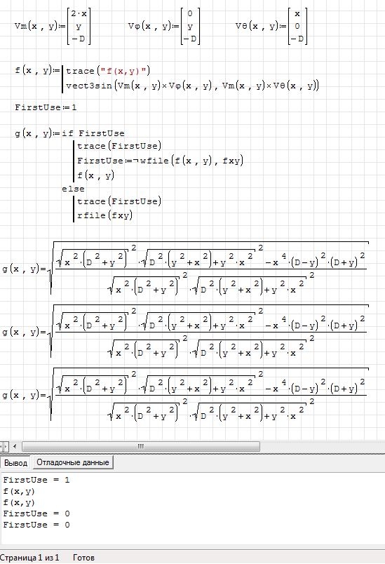

1,558个赞,共1,868个帖子。
Something like this?

Thanks to Martin and Viacheslav for working solutions!
As I understood, there is no regular way in SMath to access already existing result of symbolic evaluation. The solutions are tricks to export the result to string/file and to import it back.
