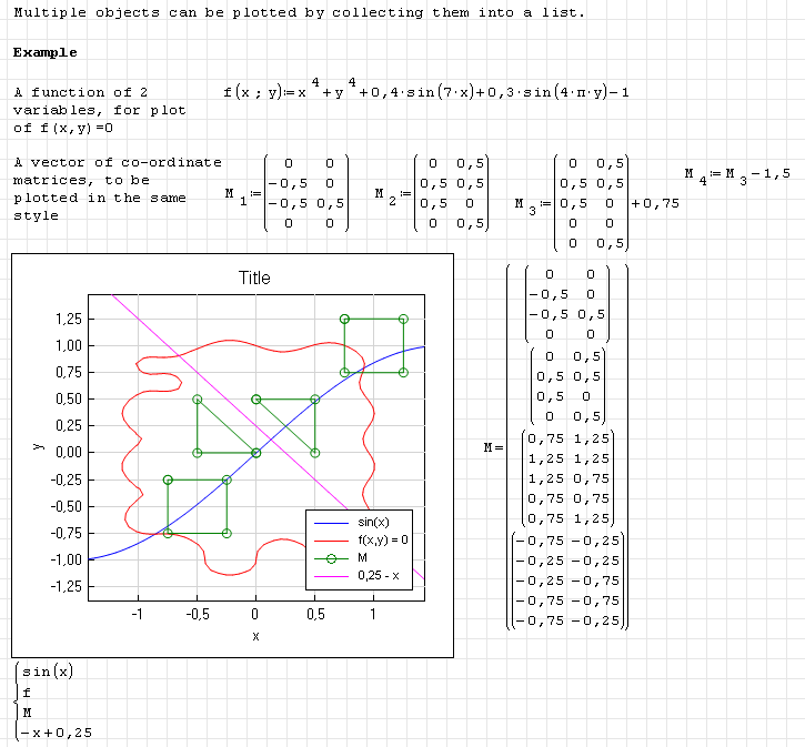

I am wondering if anyone can provide some advice on the best way to create an interaction diagram for axial and bending.
For example, a reinforced concrete column.
The basic process to form an interaction diagram is to assume the location of the neutral axis then to perform a bunch of smaller calculations/checks and finally end up with the column axial and bending strength.
If I want to plot these results do I need to set up the calculation so that all these small steps are part of the same 'for loop'?
Or if I want to calculate the moment and axial strength at certain points then plot the result of these points; I suppose I could just repeat (copy/paste) the calculation for each point and record the Moment and Axial capacity then plot these values.
Any thoughts on this?
I can attached a spreadsheet or calc of what I'm trying to accomplish if that would help.

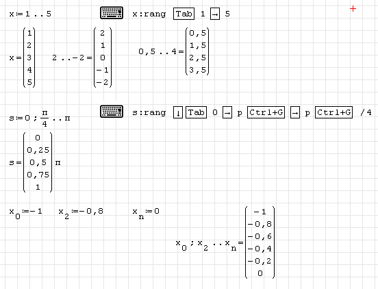

First, thank you.
Second, quick question, in the 'for' statement shown above (for i from 1 to n+1) how do you get the two periods (the "to" part of it)? What keys are pressed?
