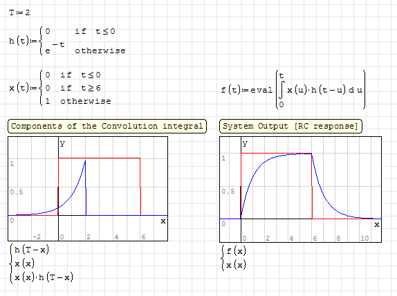

#1 Posted: 2016/5/1 10:59:06
This demo is constructed by parts. As it looks, only Mathcad 8/11
[other versions: don't know ?] supports the plotting convolviing
argument in the X/Y plot.
Convolution RC Integration.sm (47.14 KiB) downloaded 1334 time(s).

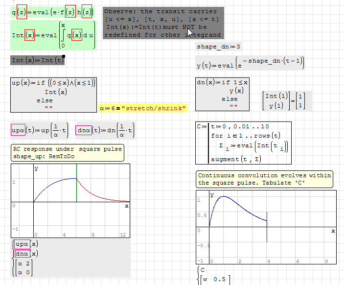

#8 Posted: 2016/5/3 12:23:47
1,441 likes in 2,932 posts.
Apparently, there are a couple of hidden changes in the symbolic engine (both to investigate carefully )
- the first change involves the transit carrier (fixes in red boxes);
- the second change involves the definition of a function using the function itself in the RHS (fixes in purple boxes; 99% s bug, the function is defined in the dynamic assistant but cannot be evaluated - "function is not defined" exception bug reported as SS-2335);
FIX attached, works with both the versions (0.97 & 0.98)
2016-05-03 17_11_06-SMath Studio Desktop - [Convolution%20RC%20Integration.sm].png
ConvolutionRC Integration [0.98.5953].sm (40.61 KiB) downloaded 1089 time(s).

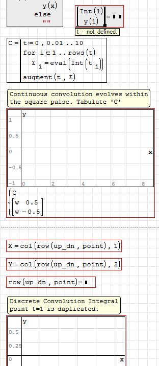

#9 Posted: 2016/5/7 10:34:03
Basile
Basile
8 likes in 172 posts.
The simplicity of the previous version has become complicated.
but does not work. Any ideas?
Basile

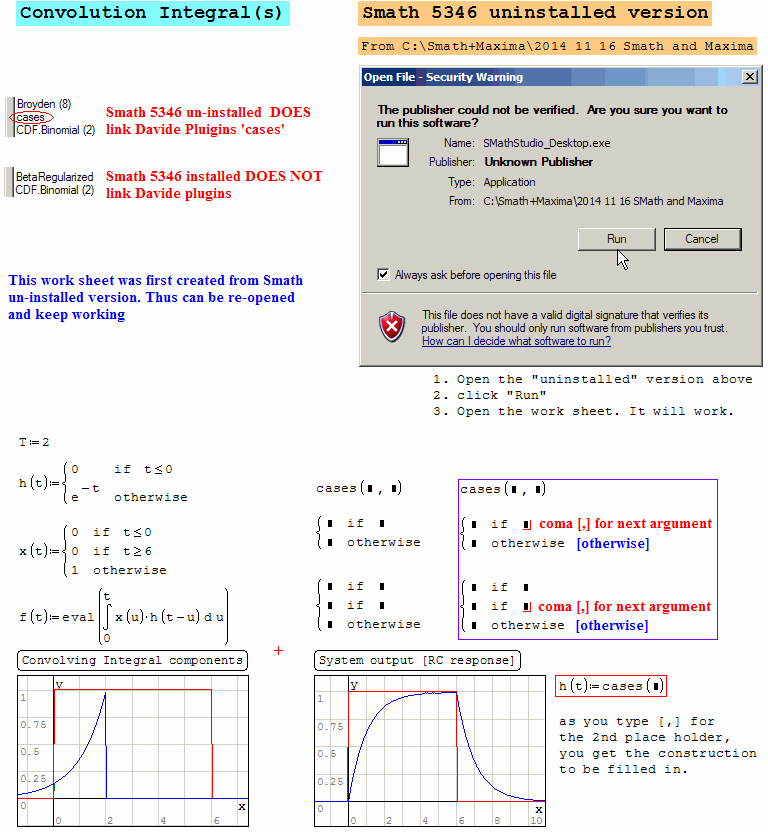

Ndtma, Sergio, Basile: the above explanation concerns your 5953.
It may also suffer the same logical link bug as 5346 ... like this again.
There are two versions of 5346: the installed version and the NON-installed versions.
Both have substantial differences in what the plugin manager links or does not link
wrt the f(x) menu. For instances: the installed version does link to the Matlab functions
mwxxxxx, the UN-installed version DOES NOT link mwxxx Matlab library, but does link Davide plugin for module 'cases'.
The installed 5346 DOES NOT link Davide plugin 'cases', does not link +++ stuff ...
Levenberg-Marquardt just to cite one.
All what I'm talking about is XP Home SP3. Something else to explore with other WIN OS.
Read again and again what I wrote, up until the brain responds. I know what what I'm
talking about, proof:
Works/does not work is not enough for designers. Prove your assertion(s).
