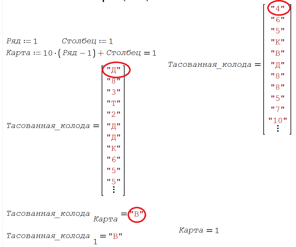

What is it with vector?
Patience.sm (37.01 KiB) downloaded 1254 time(s).

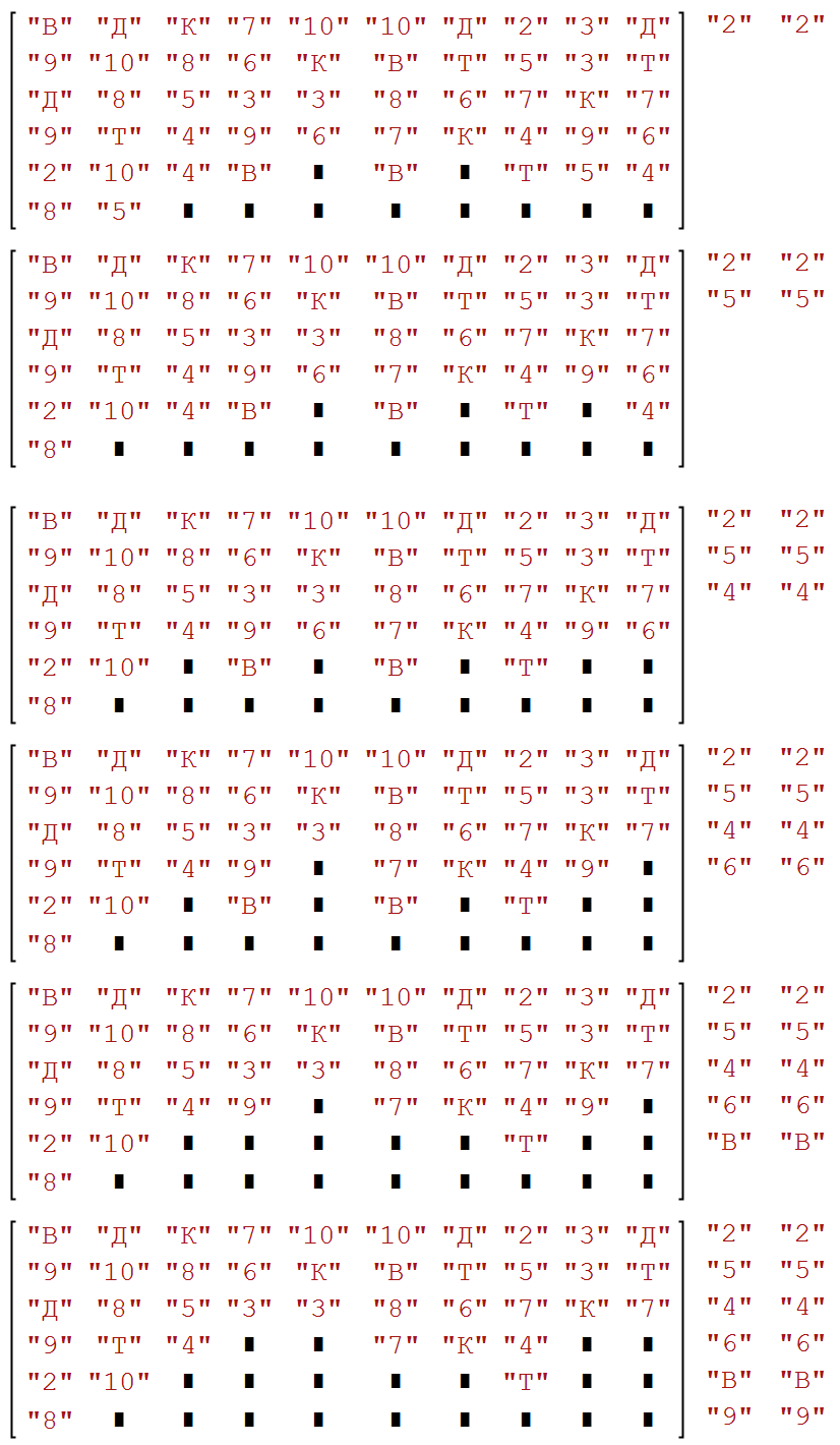

Sorry!
It is one strange bug, I think.
Without the program - all ok!
Patience.sm (37.01 KiB) downloaded 1239 time(s).

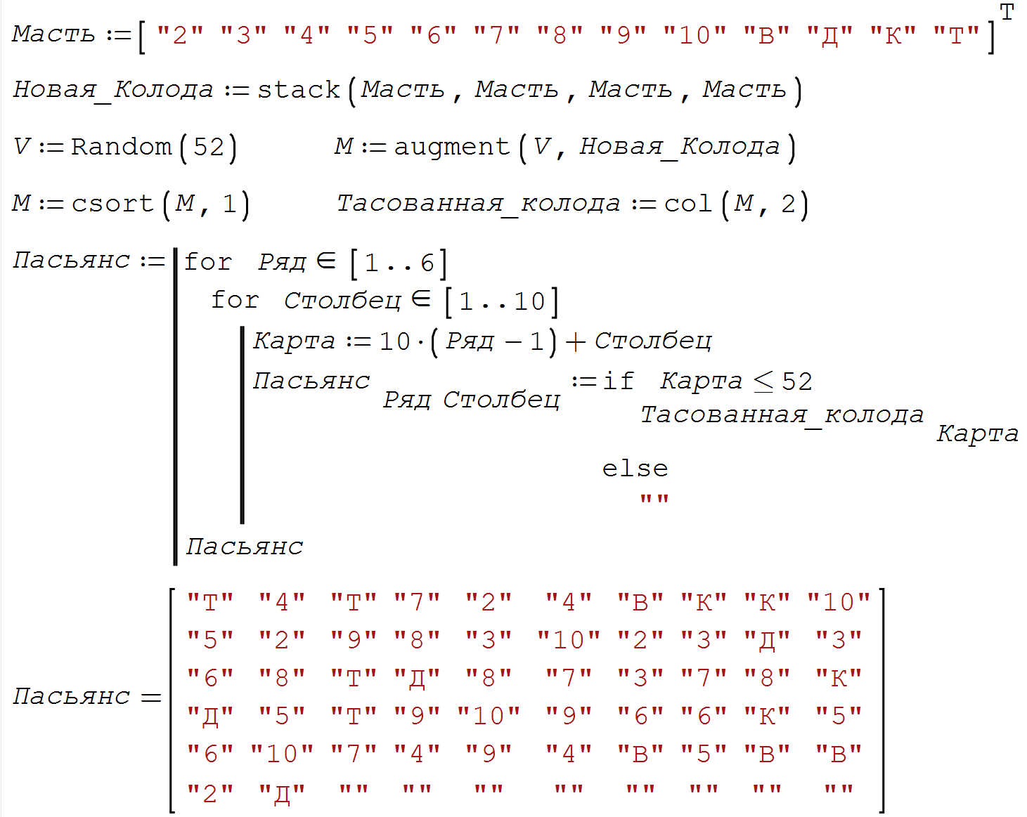

Greetings,
I wasn't able to reproduce the error, but it appears as if the Random() function is somehow redefining your variable every time you call "Тасованная_колода" to display.
May this be of Good Help;
⚜ Kenny Lemens, P.E. ᵂᴵ
#4 Posted: 2024/8/7 20:11:42
1,106 likes in 1,784 posts.
Hi. It's not a bug, but a feature. Use eval to pin up the function value.
