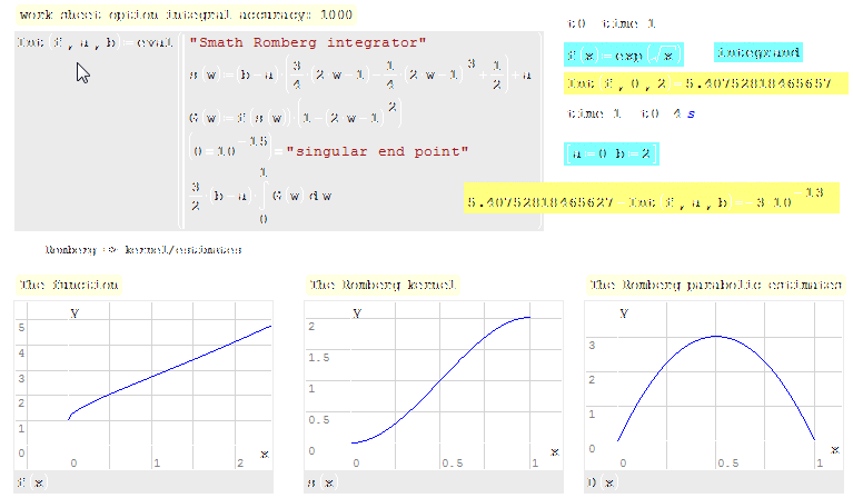

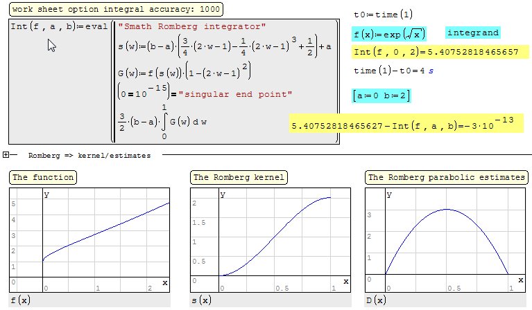

How come this screen shot was crap ?
Test a new one.
#30 Posted: 2017/5/25 10:17:44
Try again ...
#31 Posted: 2017/5/25 10:25:12
I'm replying to myself:
No matter the size of the screen shot, XP Home were all correct in the Forum.
Since I'm on Win 7 Laptop, above an unknown size, screen shot are crappy !
