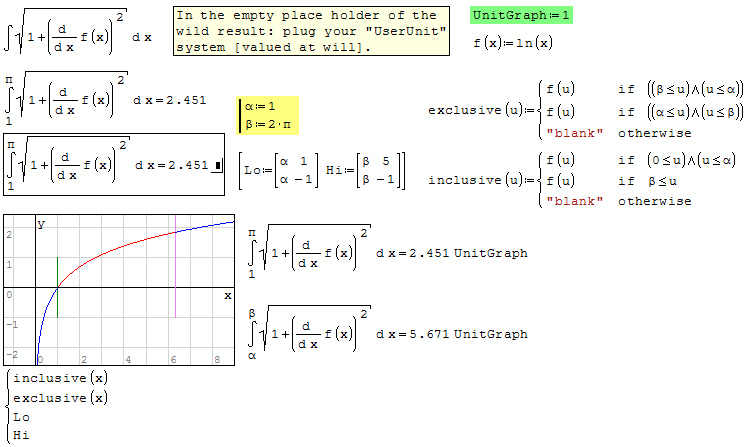

Hello David,
Many Smath users are "pro" using the unit system, not me because unit system
does not pass QA [Quality Assurance]. From a wild result [not unit affected],
you can post-add your own system.
UserUnit.sm (13.41 KiB)已下载 1202 次。

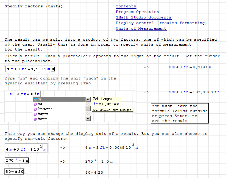

I cannot create this system of units by changing the constant.xml and units.xml sheets because the underlying structure is different. I have also created worksheets with unit definitions that work, but the software wants to produce the results in SI units, which is really messy. I need to have the results in the native units I have devised.
Maybe, it is as easy as typing the unit you want for the result in the square black placeholder?

My own units like this:
(me:=1)≡"mass of electron "
(e2:=1)≡"electrostatic charge squared"
(eemax2:=1)≡"electromagnetic charge squared"
(λC:=1)≡"Compton wavelength"
(Fq:=1)≡"quantum frequency"
Variable name can only be letter(s), some symbols, underscore
Variable names can't be mixed with arithmetic operators.
So, if you have a result about the mass of big electron, per say
mybigelectron=123456.789
in the right most place holder of mybigelectron=
paste me from the definitions upstream the document
to read => mybigelectron=123456.789me
Something like: 2 onions + 1 carrot= onion soup
1 onion + 2 carrots= carrot soup.
I have more recipes ! Cheers, Jean
... ≡ is the fat = [Ctrl+=]
