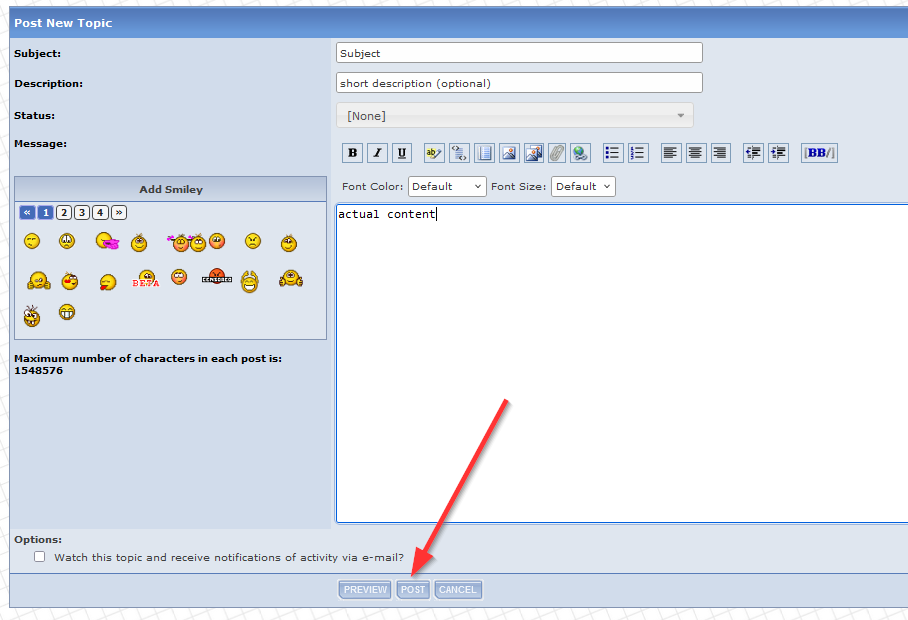

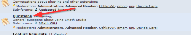

To start a new topic:
1. Click on the section relevant to your needs:

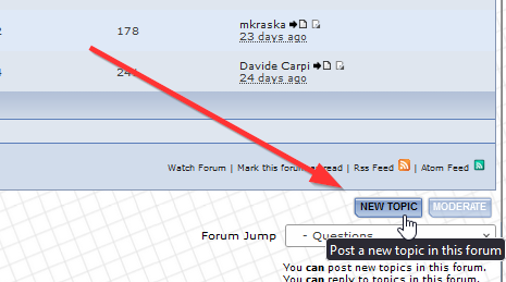

2. Click on the "NEW TOPIC" button on the bottom-right corner
3. Write your post and submit it(optional, before posting you can use the preview button to get a preview of the formatting/composition)
