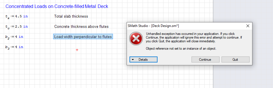

#6 已发布: 2020/12/29 11:30:25
Jason McCool
Jason McCool
9个赞,共78个帖子。
I'm getting an unhandled exception error when copying text regions by highlighting an existing text region and using the Control key + mouse to copy it. It does continue without crashing, and I can apparently copy by highlighting and using Ctrl-C and Ctrl-V, or by using the buttons on the menu bar. So far it only seems to be the Ctrl + mouse method of copying that used to work and doesn't in this build. Formulas still can be copied and pasted that way without error.
Thanks,
Jason
Andrey Ivashov 2020/12/29 16:18:00
#7 已发布: 2020/12/29 16:19:33
2,344个赞,共4,057个帖子。
组: Super Administrator
Thank you!
The reason of this error is the same as it is in the issue [USERLINK]Razonar[/USERLINK] mentioned above. Fixed now.
Jason McCool 2020/12/29 16:22:00
