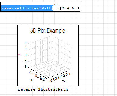

In this period I am using Smath a lot .
Probably I have still not a clear idea of the keyboard shortcut and of other technique for copy & paste of element ...but there is something that I consider a litte bit frustrating when I work; I guess that is normal that while I am writing on the canvas I would like to copy & paste a piece of a formula somewhere else but when I do this comes up always the 3d graph as below reported ( I tried to copy the part of a formula hilighted in blu ) .
So I need to delete everything than place an equal somewhere and do again the copy & paste of a formula
SShot.png There is no way in the future to improve on this ...or as usually I am missing some simple method to avoid this behaviour.
Thanks in advance and best regards
Franco

#2 Posted: 3/14/2016 8:23:12 AM
1,443 likes in 2,935 posts.
That's a wrong implementation in the plugin;
probably there is:
		public string[] SupportedClipboardFormats
			get { return new string[] { DataFormats.UnicodeText }; }
that should be:
			get { return new string[0]; }

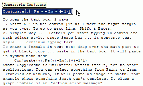

#3 Posted: 3/14/2016 10:03:21 AM
Franco: like this

#5 Posted: 3/14/2016 11:02:55 AM
frapuano
frapuano
13 likes in 115 posts.
Yes Jean exactly.
Your workaround is to place a very small text box on the canvas and then copy & paste the formula or part of it over there.
It is manageable , not as we are accustomed in all [MS] Office or other SW over this earth ...but manageable.
Hope that in a +/- distant future this issue can be addressed.
Franco
#6 Posted: 3/14/2016 7:46:39 PM
Hope that in a /- distantfuture this issue can be addressed.
I see that Viacheslav has updated the plugin (3D Plot Region version 0.1.5917.*), download it and everything should go fine.
#7 Posted: 3/15/2016 3:10:32 AM
frapuano
frapuano
Downloaded ( better to say that I have upgraded all the plug-in ) and the problem is fixed now.
Thanks a lot to you and UNI
Franco

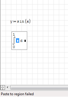

#8 Posted: 3/15/2016 4:35:33 AM
frapuano
frapuano
I really apologize to bother again on the usability side but there are problems of copy & paste directly something from a formula in the following operators available in the functions palette:
Summation
Iterated product
Derivative
Definite Integral
If this issue could be addressed I guess that it would be a big benefits for everyone to streamline the workflow.
Franco
Davide Carpi 3/15/2016 6:09:00 AM
#9 Posted: 3/15/2016 6:11:24 AM
Confirmed. "Past to region failed" appears.
new issue opened: SS-2305

#11 Posted: 3/15/2016 11:07:59 AM
frapuano
frapuano
Joan,
I am talking of very basic things in the normal usage of a program ( every program that we are accustomed to use )and an Example of the issue is in the e-mail of Davide.
However just to be clear let's try to do a definite integral of sen(x) from 0 to 1 in Smath.
I click on the Functions palette on the Definite Integral operator.
It comes up on the canvas ..then I want simply copy & past the sin(x) function that I have used 2 milliseconds before in another part of the canvas ..and this is NOT possible .
...And the same issue happens for all the other 3 operators included in my e-mail , for all the other ones in the same palette there is no such a type of problem.
Hope that it is clear the issue even if I haven't supplied a picture
Franco

#13 Posted: 3/15/2016 1:33:29 PM
2,343 likes in 4,042 posts.
...there are problems of copy & paste directly something from a formula in the following operators available in the functions palette:
Summation
Iterated product
Derivative
Definite Integral
Fixed in http://en.smath.info/forum/yaf_postst7361_RC3--SMath-Studio-0-98-5918--15-March-2016.aspx.
Davide Carpi 3/15/2016 1:58:00 PM
#14 Posted: 3/15/2016 1:53:49 PM

#15 Posted: 3/15/2016 3:33:12 PM
So as you can see a vary super basic operation is not allowed.
It works with latest nightly build: http://en.smath.info/forum/yaf_postst7361_RC3--SMath-Studio-0-98-5918--15-March-2016.aspx
Just try it.
#16 Posted: 3/15/2016 3:47:14 PM
frapuano
frapuano
Yes it works fine Andrey , thanks a lot for the prompt fix.
Franco
