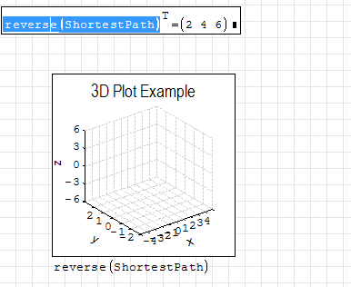

In this period I am using Smath a lot .
Probably I have still not a clear idea of the keyboard shortcut and of other technique for copy & paste of element ...but there is something that I consider a litte bit frustrating when I work; I guess that is normal that while I am writing on the canvas I would like to copy & paste a piece of a formula somewhere else but when I do this comes up always the 3d graph as below reported ( I tried to copy the part of a formula hilighted in blu ) .
So I need to delete everything than place an equal somewhere and do again the copy & paste of a formula
There is no way in the future to improve on this ...or as usually I am missing some simple method to avoid this behaviour.
Thanks in advance and best regards
Franco
There is no way in the future to improve on this ...or as usually I am missing some simple method to avoid this behaviour.Thanks in advance and best regards
Franco
ioan92 3/14/2016 9:21:00 AM
#2 Posted: 3/14/2016 8:23:12 AM
That's a wrong implementation in the plugin;
probably there is:
that should be:
probably there is:
public string[] SupportedClipboardFormats
get { return new string[] { DataFormats.UnicodeText }; }
that should be:
get { return new string[0]; }

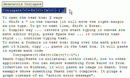

... [suite] Smath copy to its own clipboard. It means you can't
paste in other applications [Paint ...]. You must use a capture
tools or simply Windows "Print Screen". I'm using a freeware
Wingrab [from Norway]. It supports several types of 256 color
reduction, just excellent. If I want to downsample an image to
be pasted in Smath, transit via IrfanView, "ResizeResample",
it is a zoom up/down of best quality [Lanczos]. IrfanView has
a useful option to enhance poor image from the web. This option
is "Sharpen" ... very effective most of the time.
Try it ,,, Jean

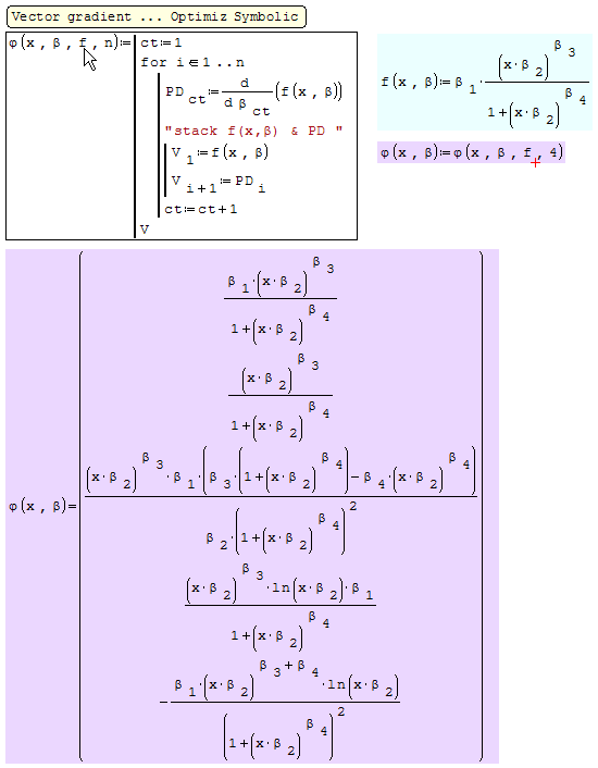

Franco,
You are doig wrong from the premise.
'f' w/o argument is uknown to me except in some Mathematica
and similar coding. Your polynomial suite is college style.
el(a,1)+el(a,2)*x+el(a,3)*x^2+el(a,4)*x^3
That style would be very difficult to implement advanced
functions, as they are coded on index parameter. Further,
it wouldn't accommodate the Genfit model fit as we use
partial derivative wrt paramaters.
Don't worry, this mishandling will come as long as Smath
will exist. Same thing in Mathcad. Just a learning step
making advanced CAS work. BTW, you mention more problems
Summation, Iterated product ... NO example.
Integrate Derivative General Procedure.sm (13.64 KiB) downloaded 1370 time(s).

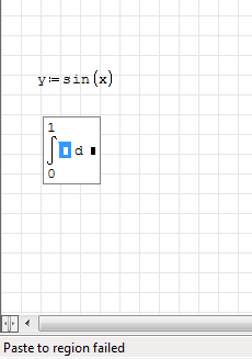

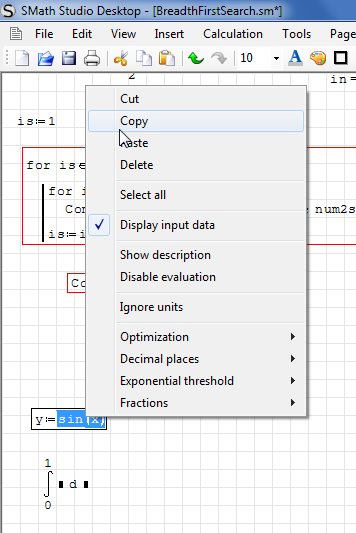

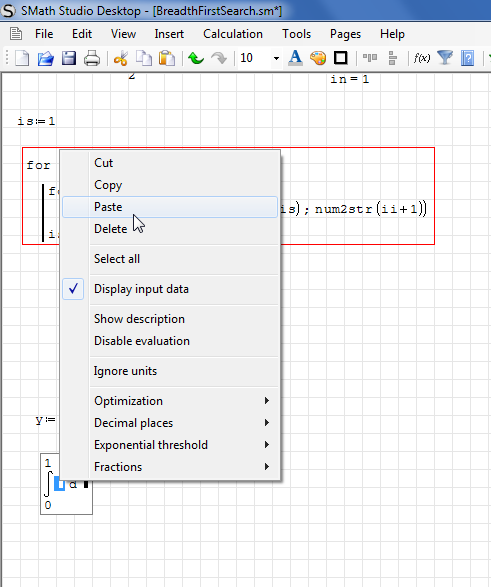

#14 Posted: 3/15/2016 1:53:49 PM
Joan
I am perfectly aware that my capability of explanation in English is very poor ..but make me worry that I have reached a so low level.
However I am famous for never give up ... and this is my new attempt in explaining what is happening, hoping to succeed this time3 ...with pictures
So as you can see a vary super basic operation is not allowed.
What I am trying to stress is the need for a CONSISTENT behaviour of the program using the same command of copy & paste with all the operators available on the palette and not with just a subset of them ...simply this.
Franco
Franco
