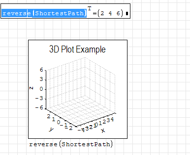

Probably I have still not a clear idea of the keyboard shortcut and of other technique for copy & paste of element ...but there is something that I consider a litte bit frustrating when I work; I guess that is normal that while I am writing on the canvas I would like to copy & paste a piece of a formula somewhere else but when I do this comes up always the 3d graph as below reported ( I tried to copy the part of a formula hilighted in blu ) .
So I need to delete everything than place an equal somewhere and do again the copy & paste of a formula
There is no way in the future to improve on this ...or as usually I am missing some simple method to avoid this behaviour.

That's a wrong implementation in the plugin;
probably there is:
that should be:
probably there is:
public string[] SupportedClipboardFormats
get { return new string[] { DataFormats.UnicodeText }; }
that should be:
get { return new string[0]; }

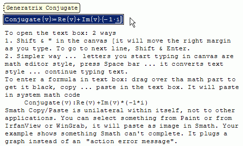

... [suite] Smath copy to its own clipboard. It means you can't
paste in other applications [Paint ...]. You must use a capture
tools or simply Windows "Print Screen". I'm using a freeware
Wingrab [from Norway]. It supports several types of 256 color
reduction, just excellent. If I want to downsample an image to
be pasted in Smath, transit via IrfanView, "ResizeResample",
it is a zoom up/down of best quality [Lanczos]. IrfanView has
a useful option to enhance poor image from the web. This option
is "Sharpen" ... very effective most of the time.
Try it ,,, Jean

Yes Jean exactly.
Your workaround is to place a very small text box on the canvas and then copy & paste the formula or part of it over there.
It is manageable , not as we are accustomed in all [MS] Office or other SW over this earth ...but manageable.

I see that Viacheslav has updated the plugin (3D Plot Region version 0.1.5917.*), download it and everything should go fine.
Downloaded ( better to say that I have upgraded all the plug-in ) and the problem is fixed now.

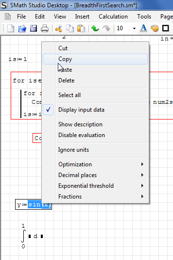

I am talking of very basic things in the normal usage of a program ( every program that we are accustomed to use )and an Example of the issue is in the e-mail of Davide.
However just to be clear let's try to do a definite integral of sen(x) from 0 to 1 in Smath.
I click on the Functions palette on the Definite Integral operator.

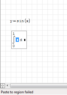

It comes up on the canvas ..then I want simply copy & past the sin(x) function that I have used 2 milliseconds before in another part of the canvas ..and this is NOT possible .
...And the same issue happens for all the other 3 operators included in my e-mail , for all the other ones in the same palette there is no such a type of problem.
Hope that it is clear the issue even if I haven't supplied a picture

Fixed in http://en.smath.info/forum/yaf_postst7361_RC3--SMath-Studio-0-98-5918--15-March-2016.aspx.

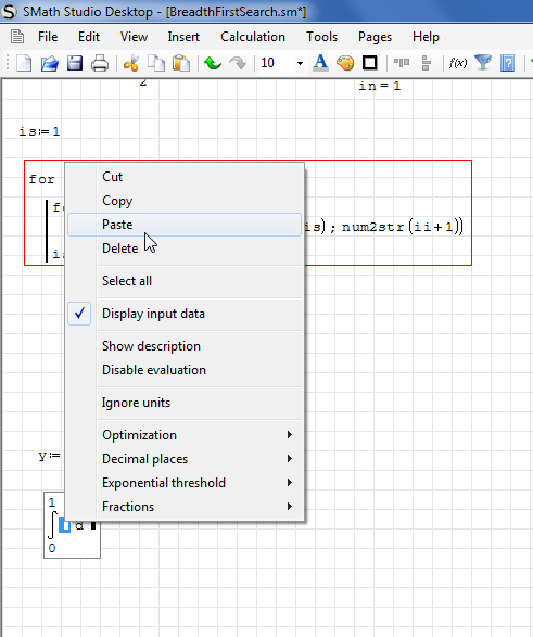

However I am famous for never give up ... and this is my new attempt in explaining what is happening, hoping to succeed this time3 ...with pictures
So as you can see a vary super basic operation is not allowed.
What I am trying to stress is the need for a CONSISTENT behaviour of the program using the same command of copy & paste with all the operators available on the palette and not with just a subset of them ...simply this.
Franco

WroteSo as you can see a vary super basic operation is not allowed.
It works with latest nightly build: http://en.smath.info/forum/yaf_postst7361_RC3--SMath-Studio-0-98-5918--15-March-2016.aspx
Just try it.
Yes it works fine Andrey , thanks a lot for the prompt fix.
Franco
