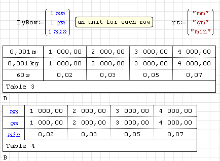

Did I get it right that the unit summary is for scaling the data by line?
By columns, by rows or global (single unit/scale factor)
[edit] attachment updated using the latest plugin's XML scheme

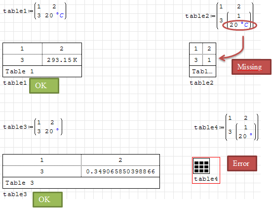

I found two issues within this plugin.
- Comma ',' as argument separator does not work probably when sub matrices are used.
- The degree symbols causes issues when sub matrices are used.
Please see my attached images.
Best Regards,
Infinity
Davide Carpi 18.02.2014 09:44:00
#34 Опубликовано: 18.02.2014 09:44:56
Thank you, I'll fix it

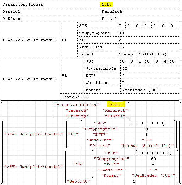

Unexpected results in Table Region. All but the first submatrices are collapsed to some strange number. Something went wrong...
NK TM1 13.sm (38,49 КиБ) скачан 1688 раз(а).
Davide Carpi 21.04.2014 13:36:00
#38 Опубликовано: 21.04.2014 13:38:50
Thank you Martin, bug added in the BTS (SS-120)
