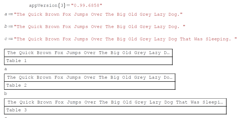

Here is an example of what I mean. "a" has no space, while both "b" and "c" have each one space. As you can see "b" has 3 missing characters counting the blank space on the end, while "c" has 4 missing characters.
Perhaps there can be a way of counting the characters in a string and then having some concatenating function add the spaces automatically depending on the length?? Just a thought...

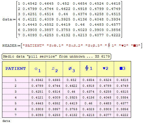

In this example [LM from Carlos], to ease the printing, the global table 'Sol'
has been rounded to 9 Decimals. This does not affect the full 15 of 'x' parameters.
"thousands of different lengths" of what ? ... poetry, numerical values ... ?
Matrix [round,n] in the collapsed area ... done SS 6179.
Levenberg_Marquardt_Code_CBG Model Copy.sm (67,9 КиБ) скачан 1660 раз(а).

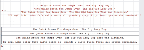

I do not know what your objective is, the case I described was for use in titles, otherwise, you can use
a matrix without worrying about using spaces as in the example below.
Table_Space_1.sm (6,68 КиБ) скачан 1551 раз(а).

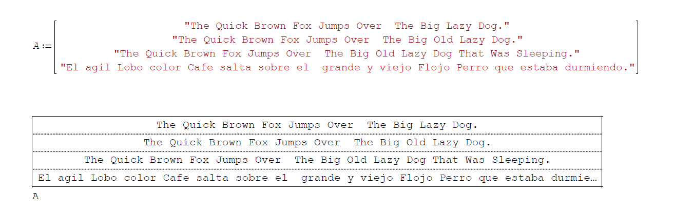

Carlos,
My original post describes my objective, but maybe it wasn't very clear? Typically I read through an entire topic so that I know what is going on, but that's just me. Not trying to be rude in any way, it just seems like I'm beating a broken drum when I have to explain the issue to every poster.
As you can see below in your example, when I PRINT, the table is cut off. All i did was download your sample and print it. As Davide said, this was an issue with the .NET framework. In any case, I appreciate the efforts to help. Thank you all very much. Hopefully Davide can eventually come up with something. In the mean time, I have used the concat() function to automatically add 4 spaces to any string i wish to display in a table. 4 spaces (as shown in a previous post) seems to cover most any length I will use.

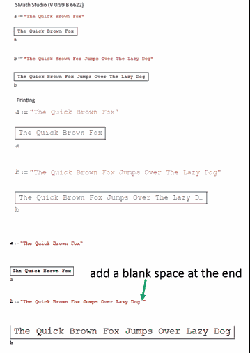

Hello wb.c
You're right, it was my mistake, since it is when it is printed in PDF format,
and not the printing of the table in the worksheet ..
I think that for now the only solution is to add the spaces.

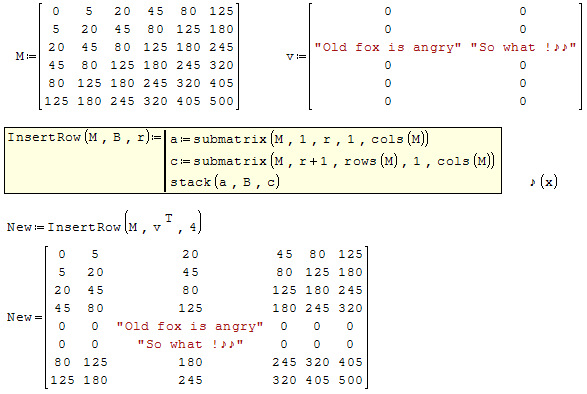

On the other hand, you can add any number of lines of text within a native
Smath matrix of data. Add line(s) anywhere => the text lines will be in
Smath default from the quote system "The wise fox ..."
I believe [not sure] you can add other symbols in the text vg: music symbol.
In most instances, final doctoring is only possible on original project.
