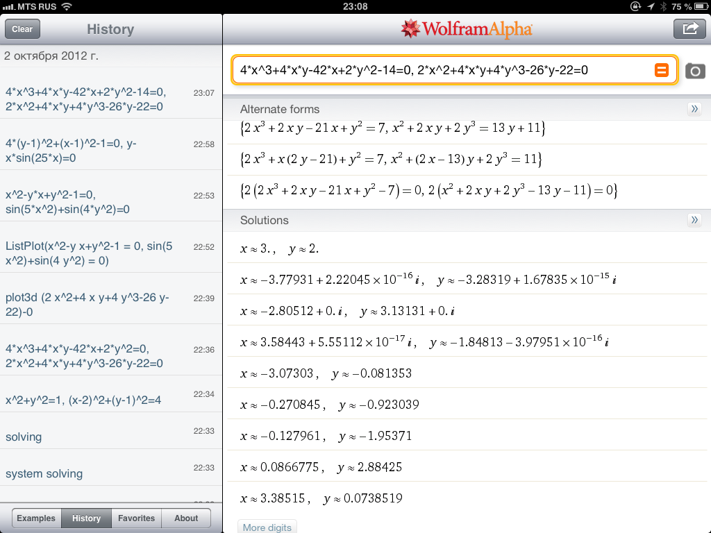

Example 1. Finding extremes: Himmelblau's function:
[MATH]f(x;y) : (x^2+y-11)^2+(x+y^2-7)^2[/MATH]
[MATH]sys(4*x^3+4*x*y-42*x+2*y^2-14=0;2*x^2+4*x*y+4*y^3-26*y-22=0;2;1)[/MATH]
P. S. Buchberger's algorithm can solve systems like that much easer.
Radovan Omorjan 02.10.2012 07:51:00, Davide Carpi 02.10.2012 10:16:00

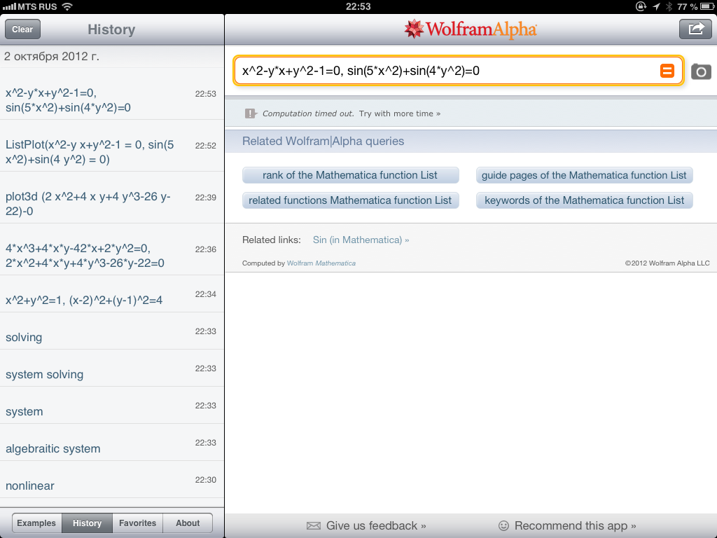

Example 2. Finding roots: System 1.
[MATH]sys(x^2-y*x+y^2-1=0;sin(5*x^2)+sin(4*y^2)=0;2;1)[/MATH]

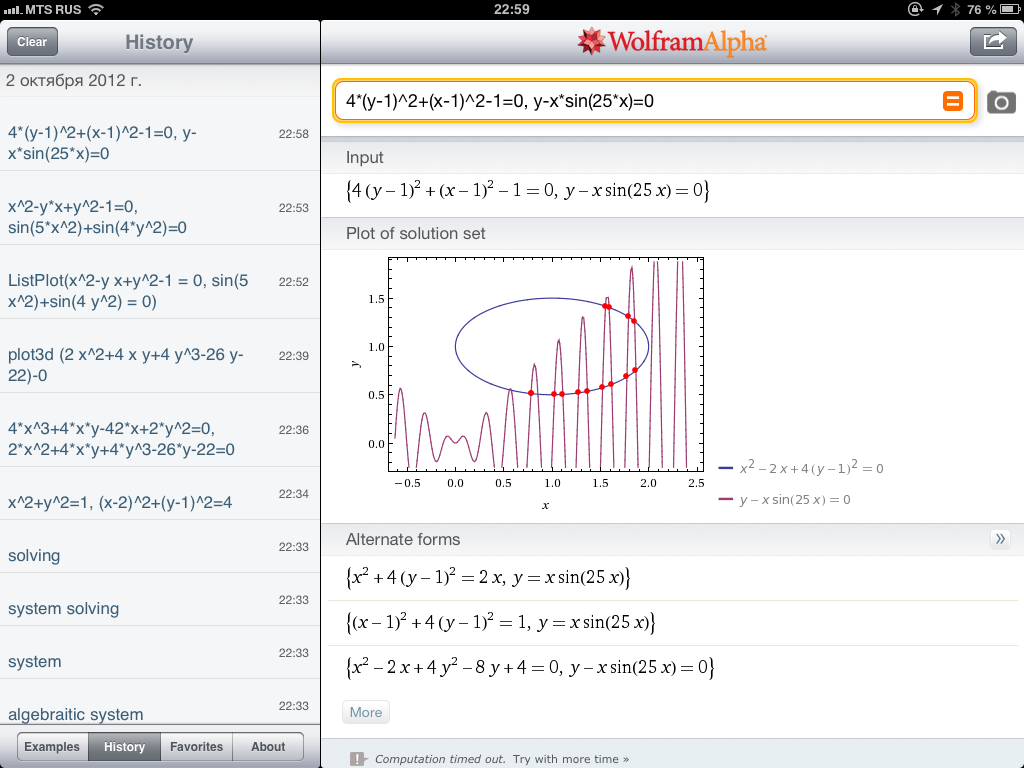

Example 3. Finding roots: System 2.
[MATH]sys(4*(y-1)^2+(x-1)^2-1=0;y-x*sin(25*x)=0;2;1)[/MATH]
Radovan Omorjan 02.10.2012 11:25:00, Davide Carpi 02.10.2012 11:40:00

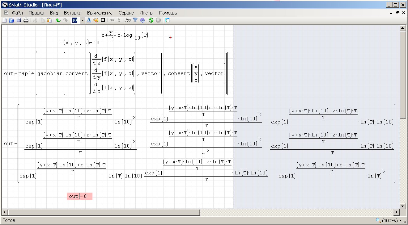

#9 Опубликовано: 04.10.2012 06:47:37
Radovan, I think this is not a good idea. This function will have zero determinant in the method.
#10 Опубликовано: 04.10.2012 07:36:12

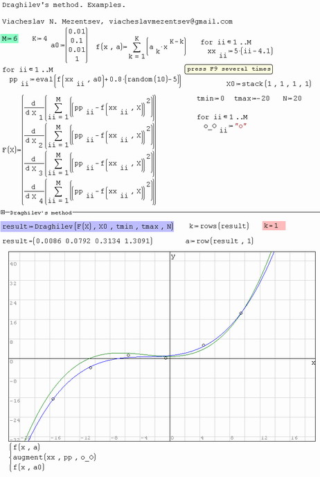

#13 Опубликовано: 05.10.2012 00:51:53

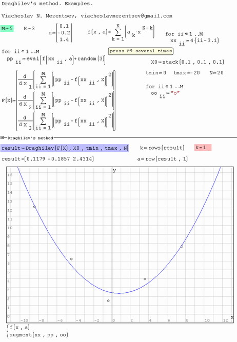

I have something fixed in the plugin. Download the new version and try to calculate this example. Everything is the same, but now it sometimes works even with five points. Then the problems begin with the maple().
Radovan Omorjan 05.10.2012 02:28:00

Unfortunately, the plugin can't correctly translate all that much data with which it communicates with the Maple. Do not forget to delete the file mvr5.txt. Here you can see the language in which the plugin communicates with the Maple. And one more example. I increased the dimension of the problem and the number of points.

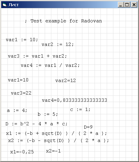

Radovan, if you want to understand it better, then you need to try to write the interpreter symbolic computation by yourself. It's not that hard. There is even an introductory book - Computer Algebra with SymbolicC++.
P.S. On the picture is a simple example of the SMath-style calculator, which is written in VB6: sources (draft, russian).
