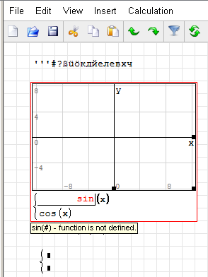

#5 Posted: 9/1/2014 6:16:25 PM
1,357 likes in 2,271 posts.
Looks promising!
That now allows to add units (' character still not working).
How are we supposed to scale 2d plots? Mouse wheel just scales the whole GUI.
Any plans to support operation of the site via touchscreen/tablet? If the cloud version could run locally, this would be a generic Android/iOS version...
#6 Posted: 9/2/2014 2:12:31 PM
2,343 likes in 4,042 posts.
Martin, please could you check input of symbols now. I think I've fixed related issues.

#7 Posted: 9/2/2014 2:35:46 PM
Confirmed. ' and ( work now, thanks a lot.
However, you might consider giving tab characters a special treatment. Currently, they appear as big spaces in math names.
