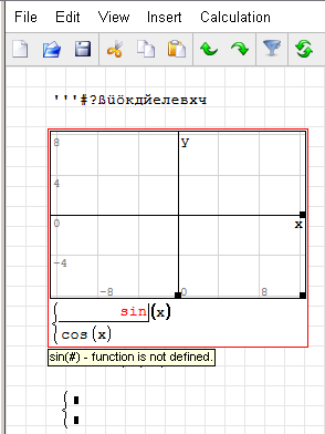

I experience input problems with german keyboard:
- cannot input units (' character does not work)
- I have to input a right (closing) paren in order to get a pair of them.
These problems also appear in smath live and in Knovel interactive equations.
Edit: Rainbow game: Modeler region does not accept input (no mouse response). Moving the modeler region makes it jump to top of the sheet, there seems to be an issue with area regions, if I open the first one, the modeler region jumps inside it and cannot be moved any more.
Edit: F5 just inserts the letter t, the other function buttons are mapped to other regions, F12 creates an empty placeholder.

Thank you, Martin. I will check this issue (hope on-screen German keyboard will help).
Actually all 3 versions of server apps you mentioned has different UI implementation (sources and logic), but all of them has SMath Studio Live engine inside (Cloud version of SMath Studio was developed separately against Interactive Equations because I have no rights to use sources and ideas developed for Knovel). As a result the same logic to handle keyboard buttons used (as initially it was created for Live). Seems I need to revise it as well.
Thanks again! Best regards.

Looks promising!
That now allows to add units (' character still not working).
How are we supposed to scale 2d plots? Mouse wheel just scales the whole GUI.
Any plans to support operation of the site via touchscreen/tablet? If the cloud version could run locally, this would be a generic Android/iOS version...

Martin, please could you check input of symbols now. I think I've fixed related issues.
Martin Kraska 02.09.2014 14:33:00
#7 Опубликовано: 02.09.2014 14:35:46
Confirmed. ' and ( work now, thanks a lot.
However, you might consider giving tab characters a special treatment. Currently, they appear as big spaces in math names.
