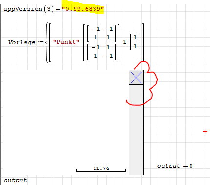

Hi!
At the moment I cannot drag any object from the template pane to the modeller region.
I am using 0.99 (6839)
But you can test it easily by opening the example in the first post online. There it doesn't work, too.
Also the tooltip by hovering the any template objects appears only rarely.
Editing already exiting objects works fine.

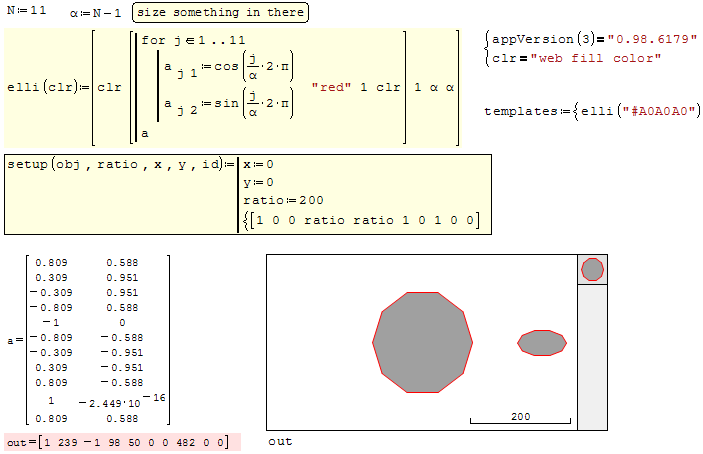

#46 Posted: 11/18/2018 9:11:55 PM
I can't add new shapes from templates bar.
You can only add shapes that you have created or borrowed from unknown sources
In this document, two objects were created and installed in the template
N =5 => yellow square
N 13 => light gray dodecagon
Check if it works in your SS version
modeller-demo-Kr.sm (15.04 KiB) downloaded 1543 time(s).

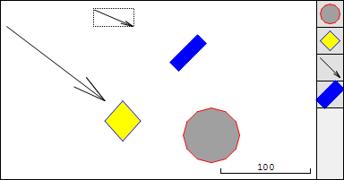

#51 Posted: 11/19/2018 9:21:08 PM
You can only zoom the modeller canvas, not the single shapes (even in previous versions).
SS 6179, zoom is by handles and thus fabricate otherwise than native.
1. The blue line come automatically 45° ... make it as thick as desired.
2. The arrow, you can rotate at will from the creation.
Observe the the empty "" fill arrow
3. Fill color applies to closed shapes
4. for some weird figure it can be done by digitizing and collecting the XY vector.
Modeler takes only pairwise XY vector ... not matrix
modeller-demo-Kr.sm (27.66 KiB) downloaded 1522 time(s).

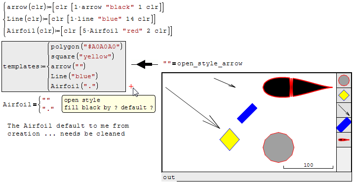

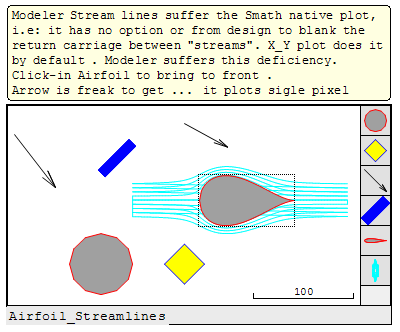

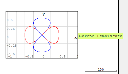

#52 Posted: 11/19/2018 10:05:03 PM

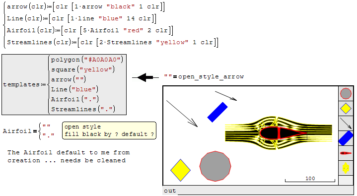

... Airfoil added Observe => [5*Airfoil,"red",2,clr]
modeller-demo-Kr.sm (39.55 KiB) downloaded 1544 time(s).
#53 Posted: 11/19/2018 10:32:35 PM
... streamlines added around airfoil
Some cleanup needed ...
modeller-demo-Kr.sm (133.16 KiB) downloaded 1570 time(s).

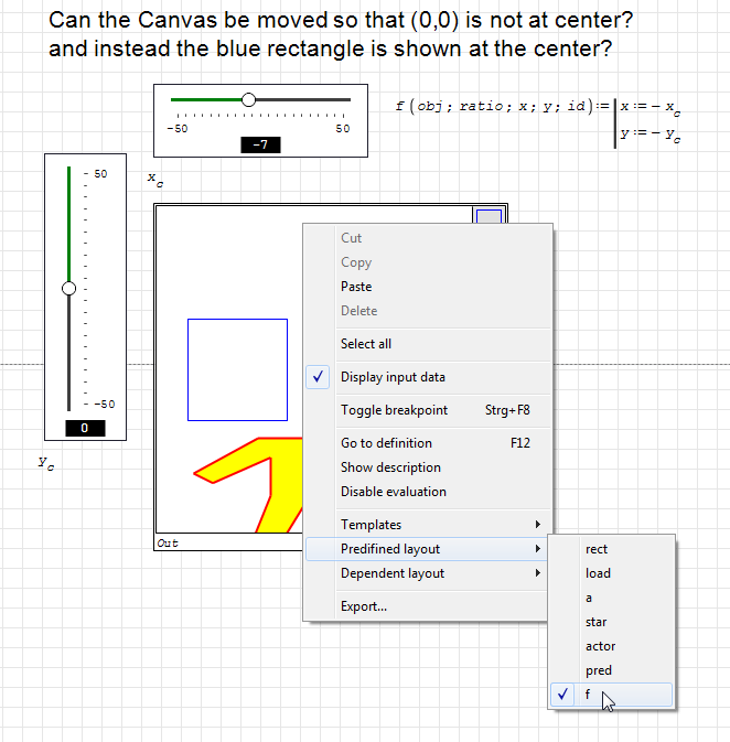

Is there anyway to have the center of the modeler canvas moved so that (0,0) is not at the center?
See attached.
Modeller - Shapes - Canvas Center.sm (11.29 KiB) downloaded 1552 time(s).

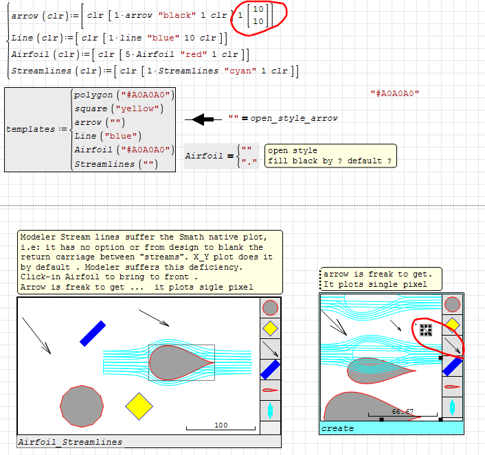

Jean, in your example you could specify an appropriate default size of the objects. Then the arrow template doesn't appear as a single dot any more.
Yes, but to make it interactive, you need slider regions. Use a function as predefined layout. It's third and fourth arguments are channels to convey the canvas co-ordinates.
The canvas is centered at these co-ordinates, evaluated for the default scale.
The default scale is given by the second entry of the dependent layout row vector.
Modeller%20-%20Shapes%20-%20Canvas%20Center_Kr.sm (13.6 KiB) downloaded 1825 time(s).
2020-01-03 14_33_43-SMath Studio 0.99.7251 - [Modeller%20-%20Shapes%20-%20Canvas%20Center.sm_].png

#60 Posted: 1/3/2020 12:00:42 PM
Thanks Martin, most appreciated ... updated.
modeller-demo-Kr.sm (162.81 KiB) downloaded 1593 time(s).
