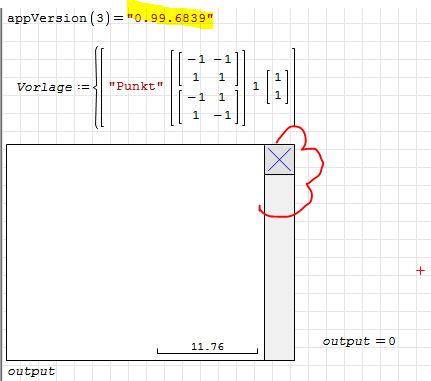

Hi!
At the moment I cannot drag any object from the template pane to the modeller region.
I am using 0.99 (6839)
But you can test it easily by opening the example in the first post online. There it doesn't work, too.
Also the tooltip by hovering the any template objects appears only rarely.
Editing already exiting objects works fine.
kind regards,
Martin

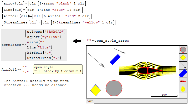

#46 Опубликовано: 18.11.2018 21:11:55
I can't add new shapes from templates bar.
You can only add shapes that you have created or borrowed from unknown sources
In this document, two objects were created and installed in the template
N =5 => yellow square
N 13 => light gray dodecagon
Check if it works in your SS version

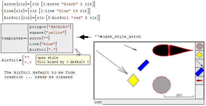

#51 Опубликовано: 19.11.2018 21:21:08
You can only zoom the modeller canvas, not the single shapes (even in previous versions).
SS 6179, zoom is by handles and thus fabricate otherwise than native.
1. The blue line come automatically 45° ... make it as thick as desired.
2. The arrow, you can rotate at will from the creation.
Observe the the empty "" fill arrow
3. Fill color applies to closed shapes
4. for some weird figure it can be done by digitizing and collecting the XY vector.
Modeler takes only pairwise XY vector ... not matrix
modeller-demo-Kr.sm (27,66 КиБ) скачан 1522 раз(а).
#52 Опубликовано: 19.11.2018 22:05:03
... Airfoil added Observe => [5*Airfoil,"red",2,clr]
modeller-demo-Kr.sm (39,55 КиБ) скачан 1544 раз(а).

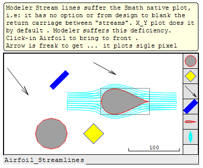

#53 Опубликовано: 19.11.2018 22:32:35
... streamlines added around airfoil
Some cleanup needed ...
modeller-demo-Kr.sm (133,16 КиБ) скачан 1570 раз(а).

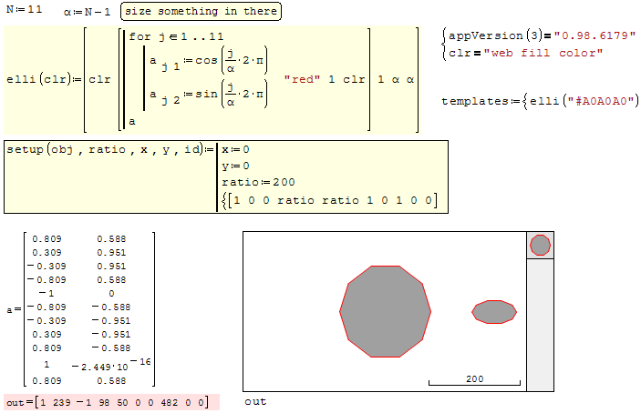

#54 Опубликовано: 31.12.2019 16:23:50
Ryan Freund
Ryan Freund
20 сообщений из 339 понравились пользователям.

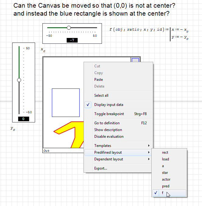

Is there anyway to have the center of the modeler canvas moved so that (0,0) is not at the center?
See attached.
Modeller - Shapes - Canvas Center.sm (11,29 КиБ) скачан 1552 раз(а).
#55 Опубликовано: 31.12.2019 17:33:43
Maybe YES ... in the attached objects are disposed/located.
modeller-demo-Kr.sm (162,97 КиБ) скачан 1512 раз(а).
#56 Опубликовано: 01.01.2020 00:02:19
AFAIK, not as you state it. Why do that ?
1. Slide the shape [circle] in the canvas.
2. Click-in to see the dotted frame [3 big black dots per side]
3. Double click to get the coordinated [X,Y]...[0,0 = centered canvas]
...width/height for circle/ellipse ...size the shape [zoom ±].
If you have some difficulties ... please don't hesitate.

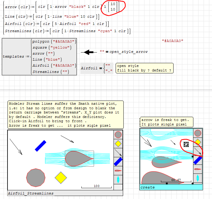

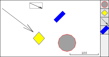

#58 Опубликовано: 03.01.2020 10:04:16
Jean, in your example you could specify an appropriate default size of the objects. Then the arrow template doesn't appear as a single dot any more.
#59 Опубликовано: 03.01.2020 10:47:42
Yes, but to make it interactive, you need slider regions. Use a function as predefined layout. It's third and fourth arguments are channels to convey the canvas co-ordinates.
The canvas is centered at these co-ordinates, evaluated for the default scale.
The default scale is given by the second entry of the dependent layout row vector.
Modeller%20-%20Shapes%20-%20Canvas%20Center_Kr.sm (13,6 КиБ) скачан 1825 раз(а).
2020-01-03 14_33_43-SMath Studio 0.99.7251 - [Modeller%20-%20Shapes%20-%20Canvas%20Center.sm_].png
Jason McCool 10.04.2021 00:34:00, frapuano 03.01.2020 15:37:00
#60 Опубликовано: 03.01.2020 12:00:42
Thanks Martin, most appreciated ... updated.
