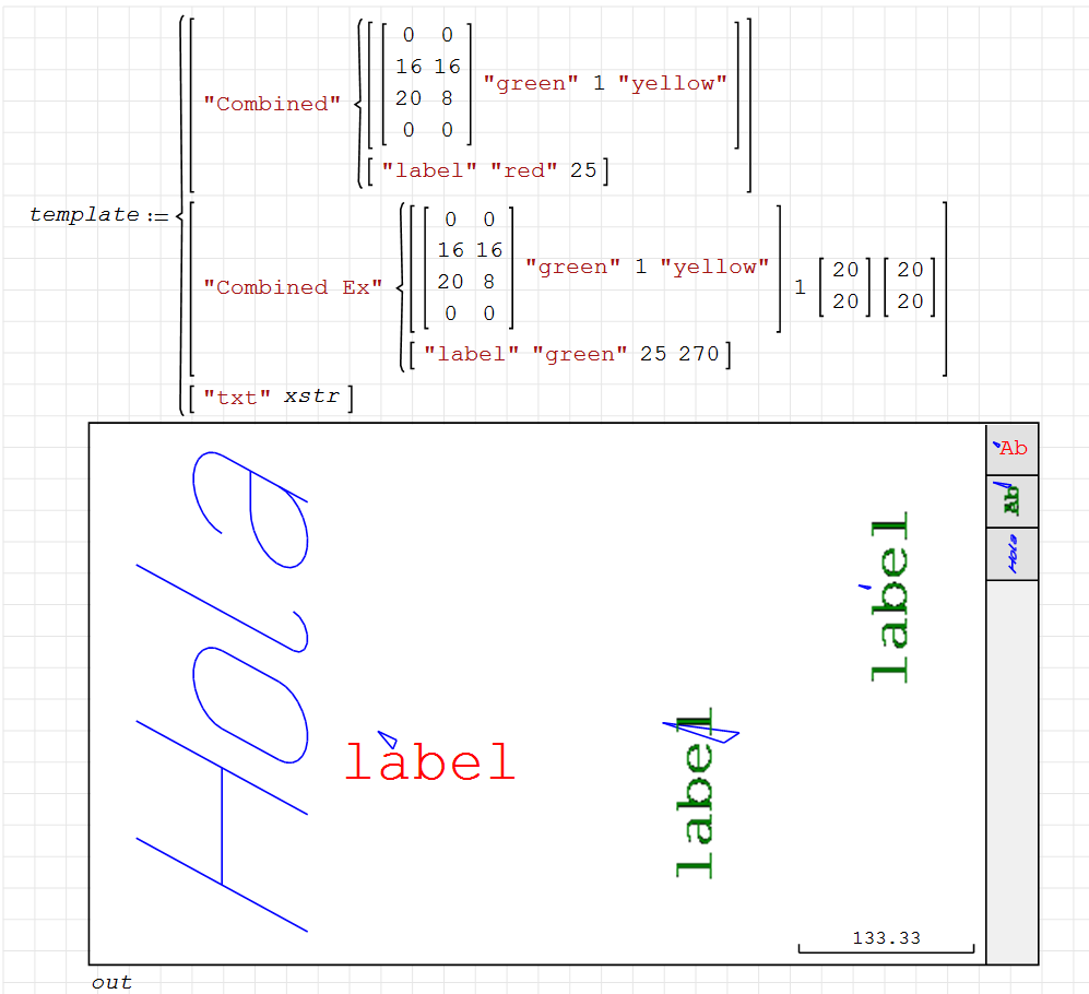

#65 Posted: 8/8/2021 2:26:40 PM
Renzo Choque
Renzo Choque
6 likes in 18 posts.
Hello, please someone knows how to rotate text in modeller region?
Hi. This is a workaround, based on https://en.smath.com/forum/yaf_postst20332_Drawing-Text.aspx
DrawingTextModeller.pdf (104.58 KiB) downloaded 992 time(s).
DrawingTextModeller.sm (278.08 KiB) downloaded 1783 time(s).
Thanks Alvaro, your implementation is very interesting, but I would like to know how to rotate the normal text (green label) without distorting it.

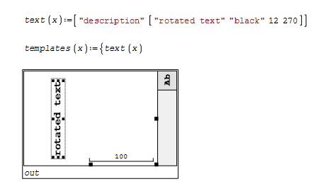

#66 Posted: 8/10/2021 7:59:32 AM
Use 270 as 4th argument to rotate 90° counter-clockwise
Jason McCool 8/10/2021 11:38:00 AM, Oscar Campo 8/10/2021 11:54:00 AM

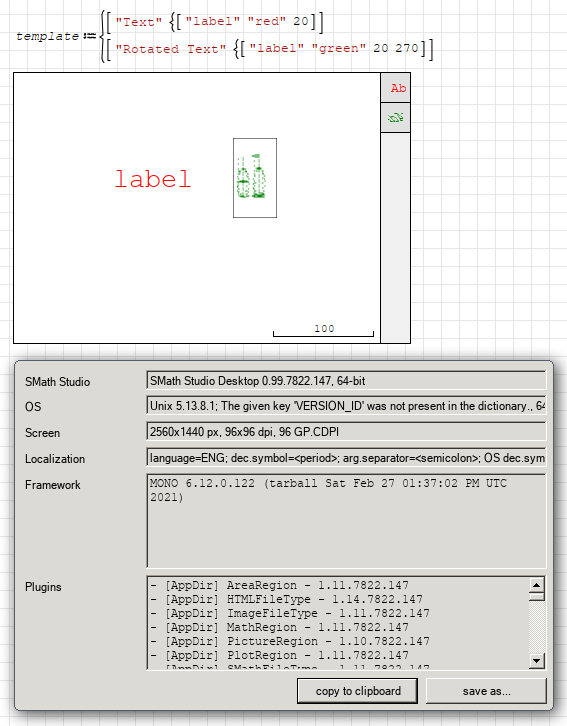

#67 Posted: 8/10/2021 12:54:54 PM
600 likes in 1,381 posts.
Text Rotation in modeller region with 270 as fourth argument is not working under Linux.
I had encountered this several months ago, maybe years. Forgot to report it.
#68 Posted: 8/11/2021 5:34:50 AM
Text Rotatior in modeller region with 270 as fourth argument is not working under Linux.
I'll look into it, thank you.

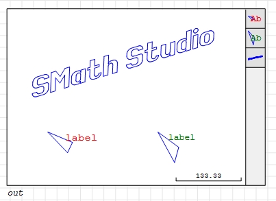

#69 Posted: 8/11/2021 10:56:20 AM
Thanks Davide for rotated text in Modeler.
modeller Rotate Text.sm (177.71 KiB) downloaded 1802 time(s).
#70 Posted: 8/12/2021 2:53:06 PM
This is how it is rendered with rotated text.
