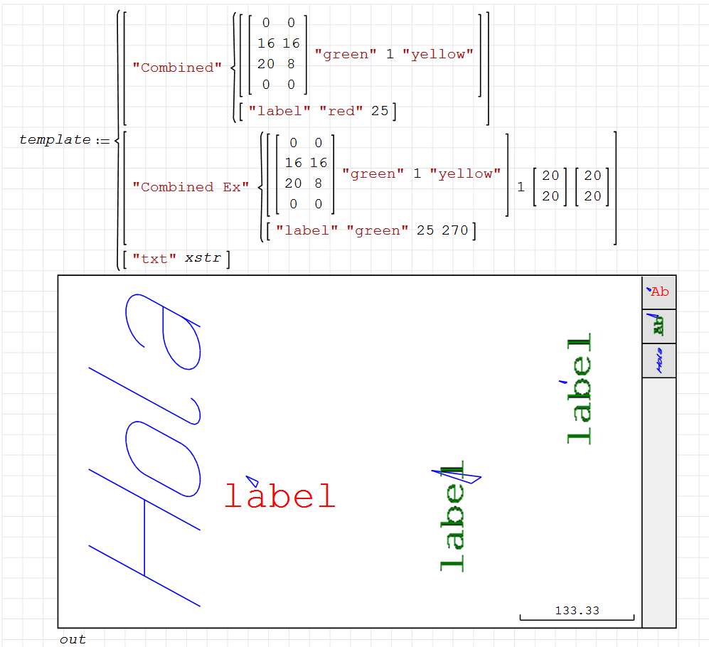

Thanks Alvaro, your implementation is very interesting, but I would like to know how to rotate the normal text (green label) without distorting it.

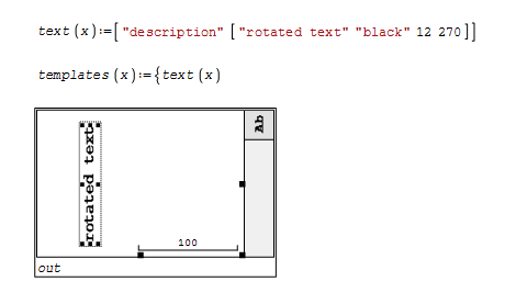

#66 Опубликовано: 10.08.2021 07:59:32
Hello, please someone knows how to rotate text in modeller region?
Use 270 as 4th argument to rotate 90° counter-clockwise
Jason McCool 10.08.2021 11:38:00, Oscar Campo 10.08.2021 11:54:00

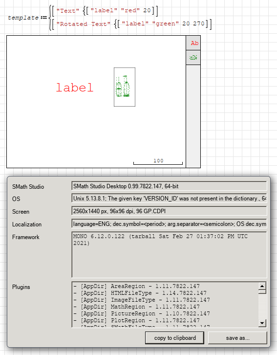

#67 Опубликовано: 10.08.2021 12:54:54
Text Rotation in modeller region with 270 as fourth argument is not working under Linux.
I had encountered this several months ago, maybe years. Forgot to report it.
#68 Опубликовано: 11.08.2021 05:34:50
Text Rotatior in modeller region with 270 as fourth argument is not working under Linux.
I'll look into it, thank you.

Thanks Davide for rotated text in Modeler.
modeller Rotate Text.sm (177,71 КиБ) скачан 1802 раз(а).

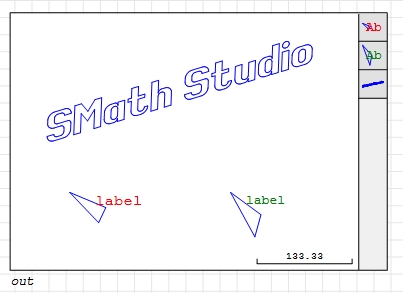

#70 Опубликовано: 12.08.2021 14:53:06
This is how it is rendered with rotated text.
