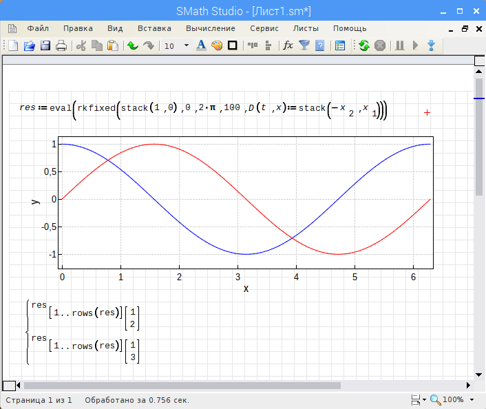

Updated. Skip intel ode assembly loading if Linux used. So in Linux only 2 functions available: rkfixed() and Rkadapt().
Raspbian on RaspberryPi 3.

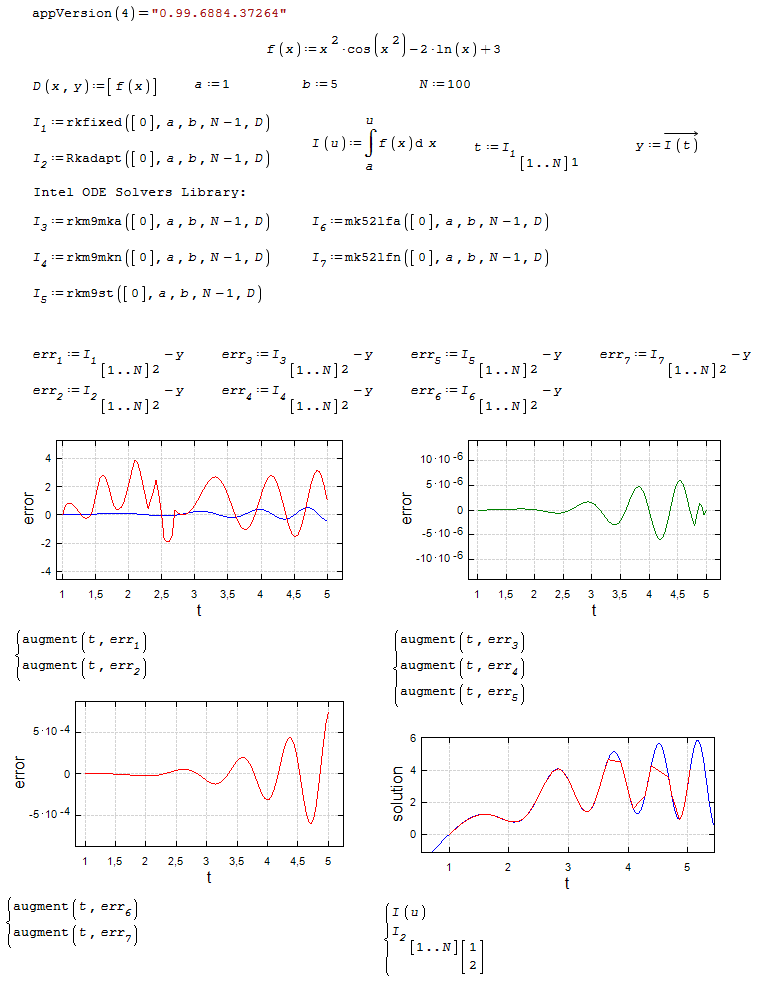

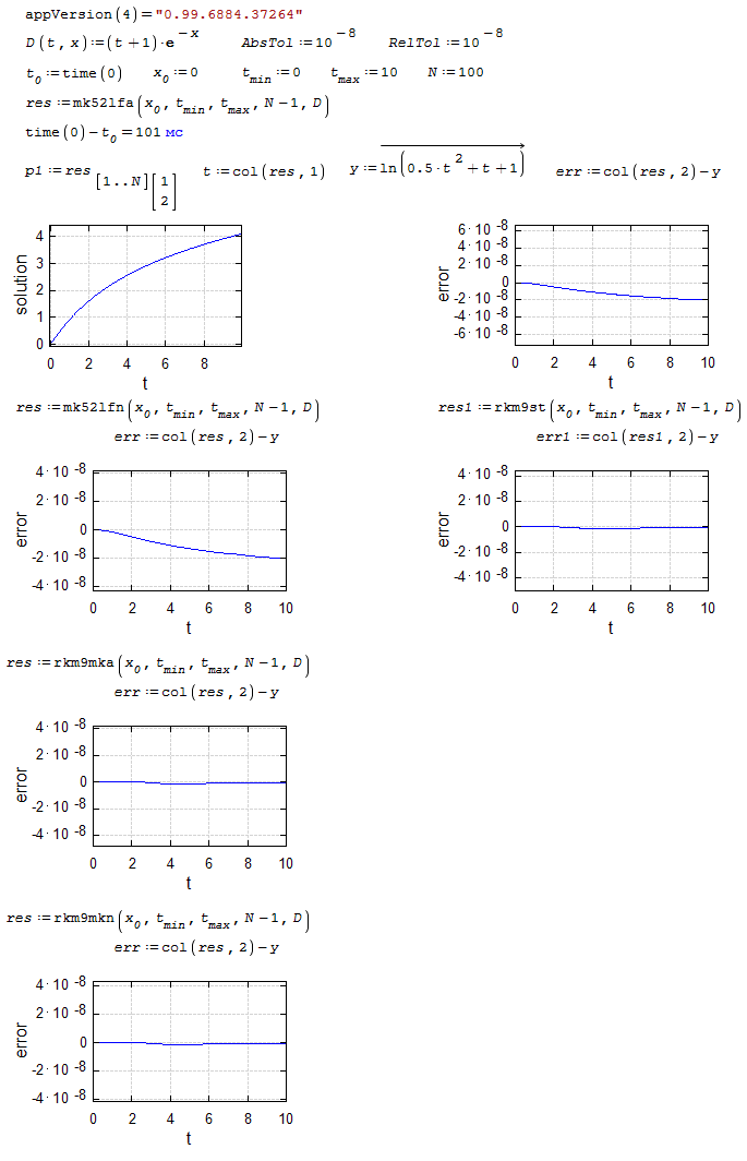

Simple intel ode test 2.
iode.test2.sm (22.5 KiB) downloaded 2273 time(s).
iode.test2.pdf (121.64 KiB) downloaded 1135 time(s).
sergio 8/1/2018 6:06:00 PM

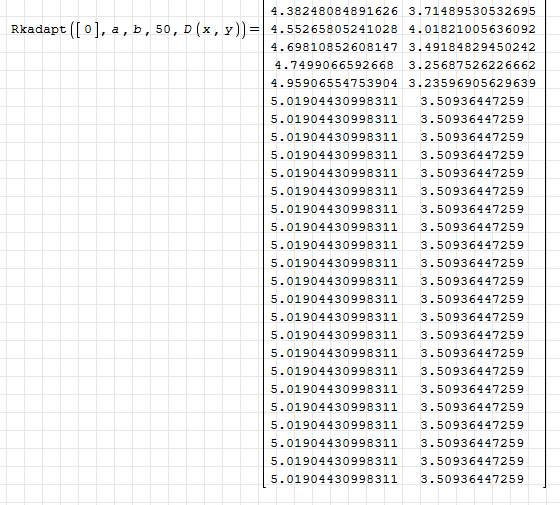

ODE test 3. Something wrong with Rkadapt().
iode.test3.sm (24.09 KiB) downloaded 1764 time(s).
iode.test3.pdf (112.7 KiB) downloaded 961 time(s).
Alvaro 12/3/2018 10:25:00 PM
#73 Posted: 12/3/2018 11:32:02 PM
1,139 likes in 1,805 posts.
Hi Viacheslav. It seems that for Rkadapt t repeats itself, at least for low N values. Maybe you can handle that with some if abs(t[n+1]-t[n])<(some tol) then do something for modify t, and not add it to the final solution. Probably it could be because your step size goes too short.

#76 Posted: 12/4/2018 9:55:44 AM
It looks OK to me from Rkadapt design.
It reaches solution in 42 steps vs fixed 100.
iode.test3 Strip Rkadapt.sm (11.15 KiB) downloaded 1758 time(s).
#77 Posted: 12/4/2018 10:17:01 AM
... In fact: Rkadapt reaches solution in 35 steps.
