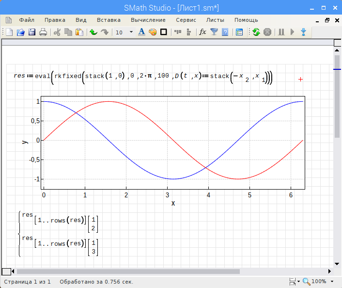

Updated. Skip intel ode assembly loading if Linux used. So in Linux only 2 functions available: rkfixed() and Rkadapt().
Raspbian on RaspberryPi 3.

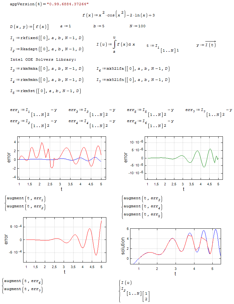

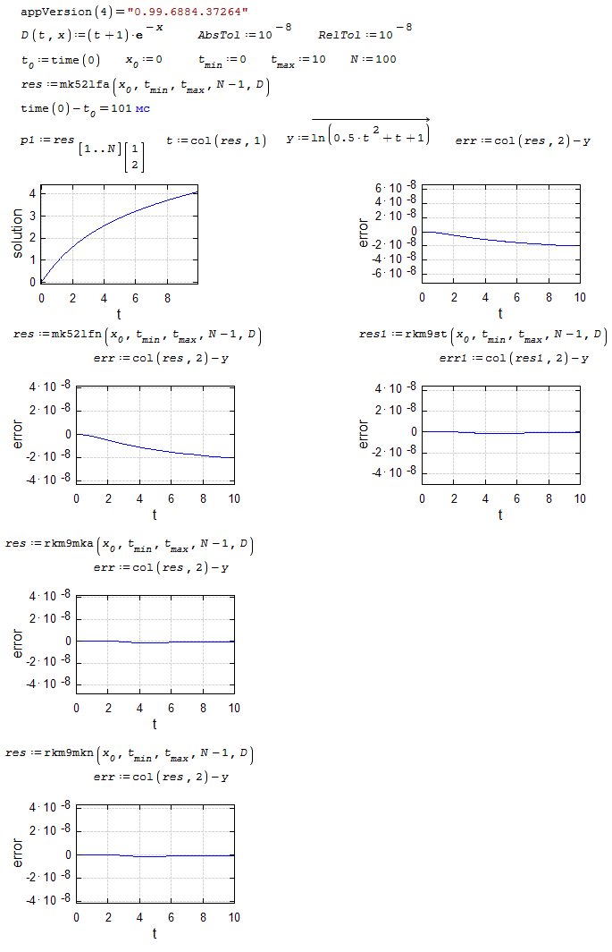

Simple intel ode test 2.
iode.test2.sm (22,5 КиБ) скачан 2273 раз(а).
iode.test2.pdf (121,64 КиБ) скачан 1135 раз(а).

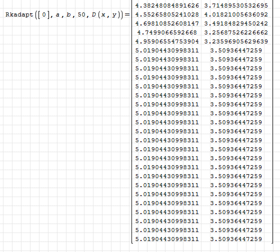

ODE test 3. Something wrong with Rkadapt().
iode.test3.sm (24,09 КиБ) скачан 1764 раз(а).
iode.test3.pdf (112,7 КиБ) скачан 961 раз(а).
Alvaro 03.12.2018 22:25:00
#73 Опубликовано: 03.12.2018 23:32:02
Hi Viacheslav. It seems that for Rkadapt t repeats itself, at least for low N values. Maybe you can handle that with some if abs(t[n+1]-t[n])<(some tol) then do something for modify t, and not add it to the final solution. Probably it could be because your step size goes too short.
It looks OK to me from Rkadapt design.
It reaches solution in 42 steps vs fixed 100.
iode.test3 Strip Rkadapt.sm (11,15 КиБ) скачан 1758 раз(а).
#77 Опубликовано: 04.12.2018 10:17:01
... In fact: Rkadapt reaches solution in 35 steps.
MCD Rkadapt results in equally spaced solutions.
MCD rkadapt comes with two extra parameters
"acc" accuracy
"s" step size
As it looks Smath Rkadapt muffs the start,
Try 34/35 => observe the result.
iode.test3 Strip Rkadapt.sm (16,85 КиБ) скачан 1798 раз(а).
