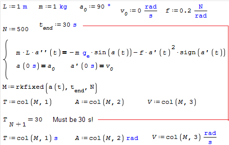

Now we can use units by ODE solution in Mathcad-block? Tanks to Slava!
But
Is it a bug?
Pendulum-Friction.sm (16.88 KiB) downloaded 1143 time(s).
But
Is it a bug?
Edited 11/5/2025 9:17:24 AM
#222 Posted: 11/5/2025 8:34:44 AM
No, all solvers don't currently support units. If something works, it's just a special case. I don't have time to rewrite the solvers to support this feature right now.
