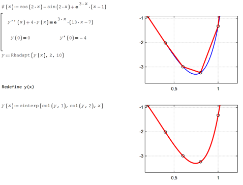

With enough points, simply cinterp Smath.
ODE HIRES.sm (67.25 KiB) downloaded 1739 time(s).

Full set: interp(), [l,p,c]spline().
Click to enlarge
Odesolve interpolation test.sm (59.06 KiB) downloaded 1721 time(s).
Odesolve interpolation test.pdf (102.91 KiB) downloaded 1082 time(s).
(*) rkfixed() with a bug now, so you will see something differ.

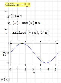

#109 Posted: 12/6/2021 12:07:58 AM
1,558 likes in 1,868 posts.

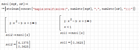

This looks very interesting. Seems that it is not yet in the online gallery?
I can't contact Andrey directly. The server does not allow compiling the sources, as there is no free space. Therefore, the latest changes are not yet available.
I've made some changes. I liked the idea with the str2num() function. Also I can override the diff(1) function, but that can be confusing.
Now it is possible to numerically solve the Cauchy problem for one variable: diff(y(x),x,n)=F(x,y(x),...,diff(y(x),x,n-1)) . Later, I will expand the rest of the ODE solvers to support this simplified form. But for this I need to combine plugins and add interpolation functions similar to Mathcad (lspline(), interp(), ...). It will be more convenient for me to test the solvers, comparing the results with Mathcad.
Block region collects equations in the form of a system and substitutes it as the first parameter into the function.
Click to enlarge

#111 Posted: 12/6/2021 9:11:48 AM
SMath Studio compatibility
Plugin updated. Please try.
Examples:
Mathcad Block.sm Mathcad Block. Examples.sm
Changes:
- rkfixed() now works correctly;
- Odesolve block renamed to Mathcad Block;

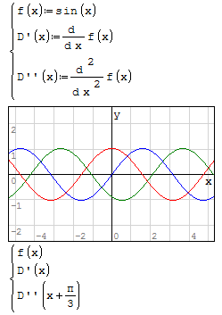

- the task for the ODE solver in the usual mathematical notation is supported;
- default diff symbol is apostrophe ( ' );
- linterp() is used as an interpolation function;
- refactored.
Click to enlarge Click to enlarge
Alvaro 12/6/2021 11:41:00 AM, sergio 12/6/2021 10:52:00 AM

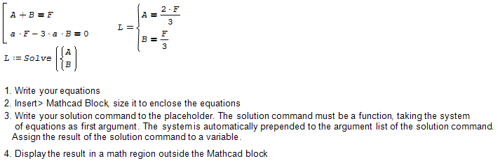

Really nice generic block concept! It is a really good reason for updating the handbook and the portable distribution.
This is how to use it with symbolic solutions using Solve() (Maxima plugin):
Solve block.sm (5.37 KiB) downloaded 1748 time(s).

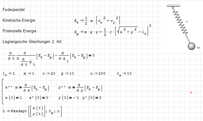

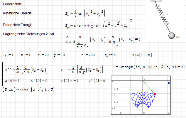

Looking forward to a RK integrator for multi-DOF systems. This is how I would imagine the user interface.
Federpendel-block.sm (48.39 KiB) downloaded 1736 time(s).
This is the next step, but the existing solution is not stable and has some bugs.
#117 Posted: 12/7/2021 11:13:30 AM
