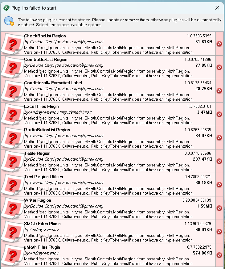

Long time user, I've been away from maths for a bit. I tend to use the portable version of SMATH and was surprised that the following plugins would not load. I have several worksheets that use the plugins and was wondering if they are now "redundant" as they are part of the core program or if I need to do something different

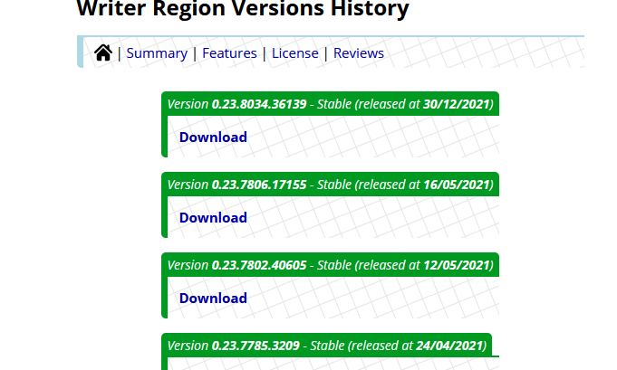

Since the extensions manager is no longer available for older versions, you have to download and install the plugins manually (downlad the zip, the drag & drop in the canvas), going back to an appropriate release date.
The link to download any plugin version is this: https://smath.info/{LOCALIZATION}/view/{PLUGIN_ID}/history

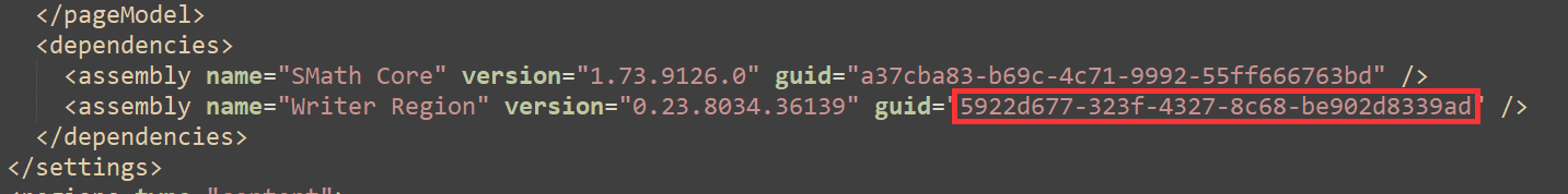

Plugins' IDs can be found in the heaader of any worksheet where you used it (using a text editor). Localization is the one that is visible in your browser when you browse the forum.

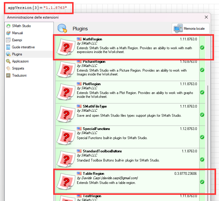

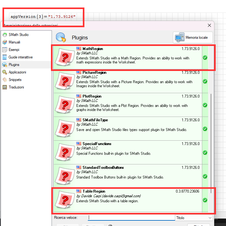

However seems you neither using the latest version too, since I see the error is somehow related to MathRegion 1.11.8763.0 that is part of SMathStudio 1.1.8763.
However in both these versions I cannot replicate the issue (at least with a fast check).
