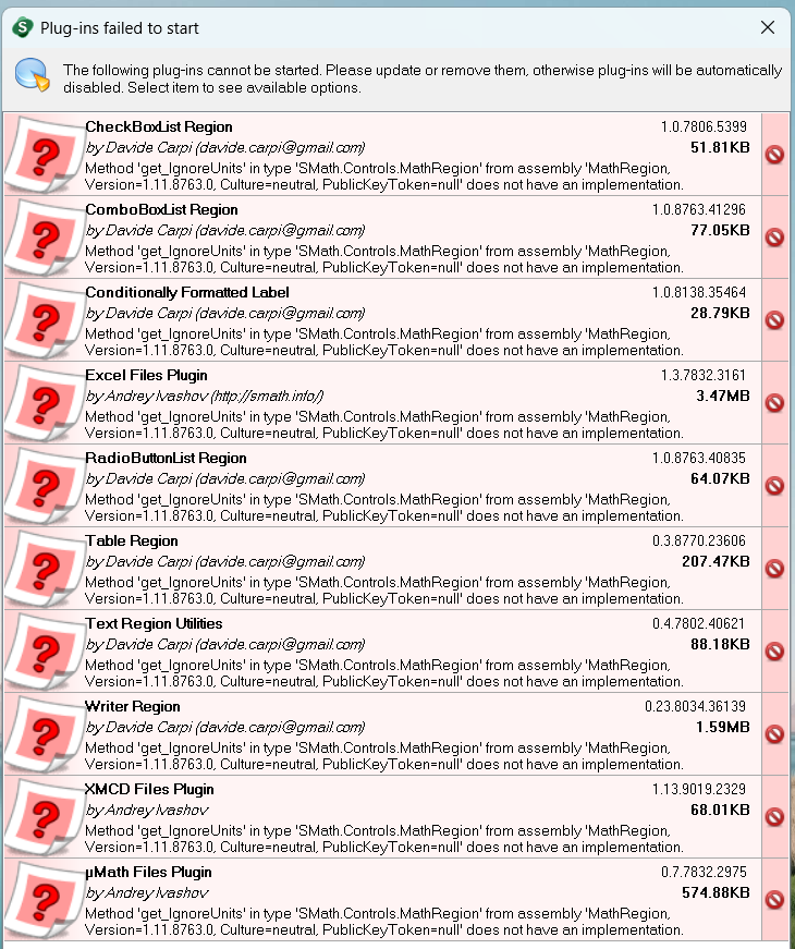

Long time user, I've been away from maths for a bit. I tend to use the portable version of SMATH and was surprised that the following plugins would not load. I have several worksheets that use the plugins and was wondering if they are now "redundant" as they are part of the core program or if I need to do something different

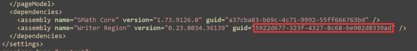

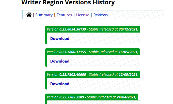

Since the extensions manager is no longer available for older versions, you have to download and install the plugins manually (downlad the zip, the drag & drop in the canvas), going back to an appropriate release date.
The link to download any plugin version is this: https://smath.info/{LOCALIZATION}/view/{PLUGIN_ID}/history
Plugins' IDs can be found in the heaader of any worksheet where you used it (using a text editor). Localization is the one that is visible in your browser when you browse the forum.

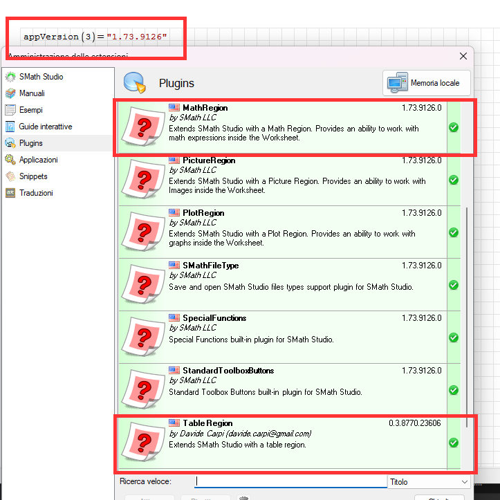

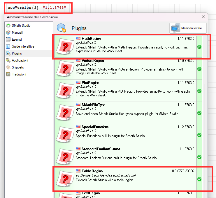

However seems you neither using the latest version too, since I see the error is somehow related to MathRegion 1.11.8763.0 that is part of SMathStudio 1.1.8763.
However in both these versions I cannot replicate the issue (at least with a fast check).
Since with these versions you can rely on the Gallery, I suggest you to:
  1. Make a copy of the "extensions\plugins" subfolder in your portable app directory
  2. delete that plugins subfolder
  3. install the plugins from the gallery again
Отредактировано 25.03.2026 09:47:18
