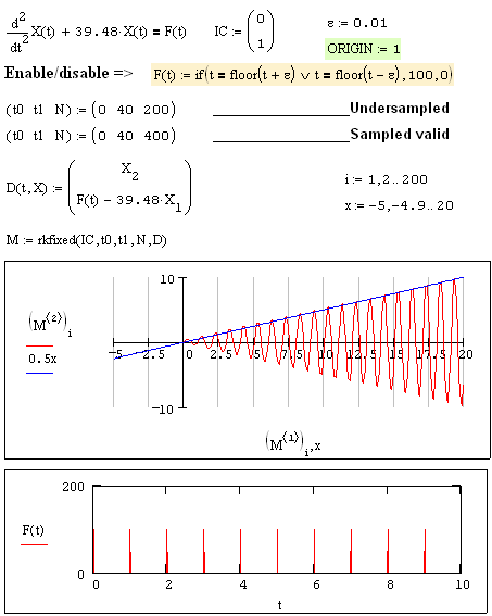

Simple test 2.
DotNumerics.ode.test2.sm (21.23 KiB) downloaded 1671 time(s).
DotNumerics.ode.test2.pdf (79.99 KiB) downloaded 804 time(s).
sergio 8/1/2018 6:06:00 PM, Radovan Omorjan 8/2/2018 3:05:00 AM
#22 Posted: 8/1/2018 9:57:14 PM
Simple test 2.
Works nice conventional/visual [6179].
That document, if it would come from other designer
would pass my QA [Quality Assurance].
DotNumerics.ode.test2.sm (24.51 KiB) downloaded 1760 time(s).

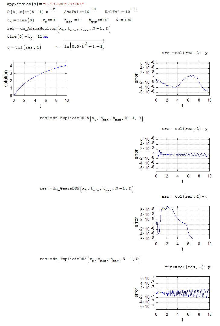

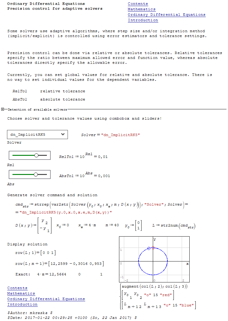

#23 Posted: 9/9/2018 2:23:36 PM
1,359 likes in 2,273 posts.

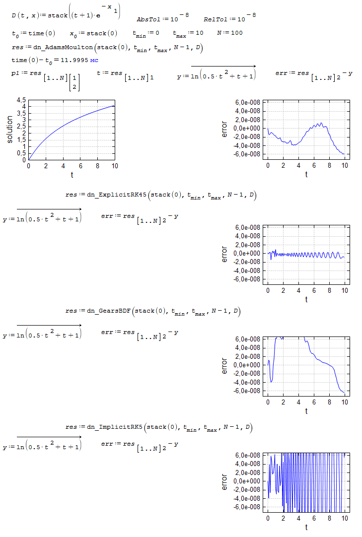

It seems that all the dotnumeric ode solver functions fail to add the last step to the solution. In the given example, the exact solution is (approximately) met if the end value of x is increased by one step (x_end/steps).
The sheet is easily extended to whatever ode solvers by adding their name to the search list. The actually available solvers depend on what plugins are installed.
Section Math ODE precision.sm (23.66 KiB) downloaded 1814 time(s).
frapuano 9/9/2018 5:18:00 PM, Вячеслав Мезенцев 9/10/2018 5:37:00 AM

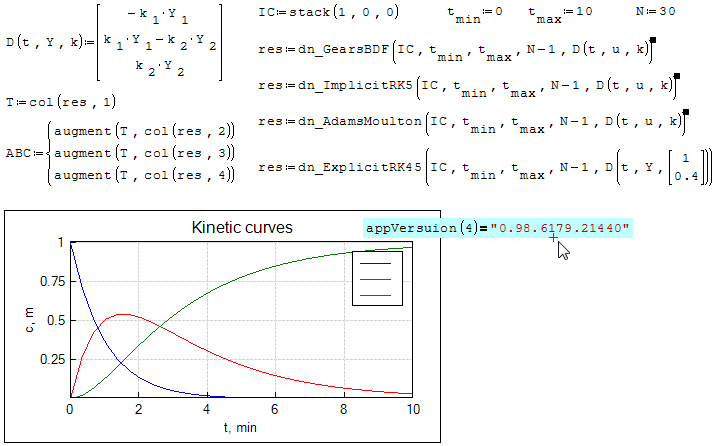

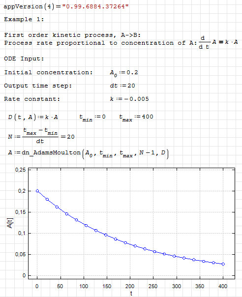

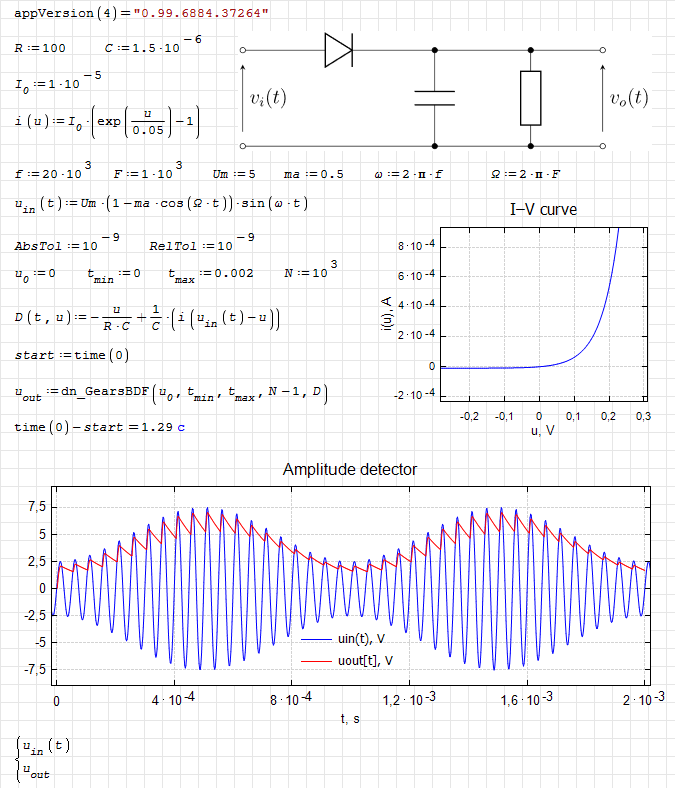

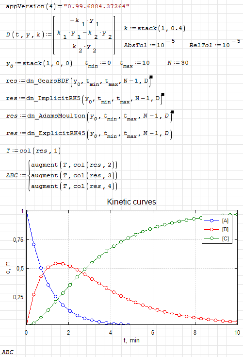

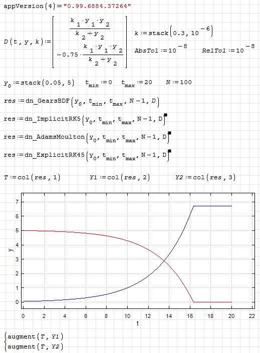

#26 Posted: 12/24/2018 9:13:53 AM
1,555 likes in 1,867 posts.
Updated.
2018-12-24_17-06-48.png 2018-12-25_04-33-23.png 2018-12-25_04-34-24.png dn.ode.test2.png dn.ode.test1.png 2018-12-24_17-07-41.png
dn.ode.kinetic1.sm (8.26 KiB) downloaded 1914 time(s).
dn.ode.kinetic2.sm (12.59 KiB) downloaded 1790 time(s).
dn.ode.kinetic3.sm (12.28 KiB) downloaded 1841 time(s).
dn.ode.test1.sm (19.58 KiB) downloaded 1856 time(s).
dn.ode.test2.sm (18.88 KiB) downloaded 1833 time(s).
dn.ode.Amplitude detector.sm (20.17 KiB) downloaded 1885 time(s).
dn.ode.kinetic1.pdf (77.42 KiB) downloaded 1041 time(s).
dn.ode.kinetic2.pdf (93.05 KiB) downloaded 978 time(s).
dn.ode.kinetic3.pdf (91.31 KiB) downloaded 962 time(s).
dn.ode.test1.pdf (115.72 KiB) downloaded 940 time(s).
dn.ode.test2.pdf (120.44 KiB) downloaded 931 time(s).
dn.ode.Amplitude detector.pdf (148.87 KiB) downloaded 982 time(s).
4 users liked this post
NDTM Amarasekera 12/24/2018 9:44:00 AM, sergio 12/24/2018 11:04:00 AM, frapuano 12/24/2018 2:23:00 PM, Radovan Omorjan 12/24/2018 2:52:00 PM

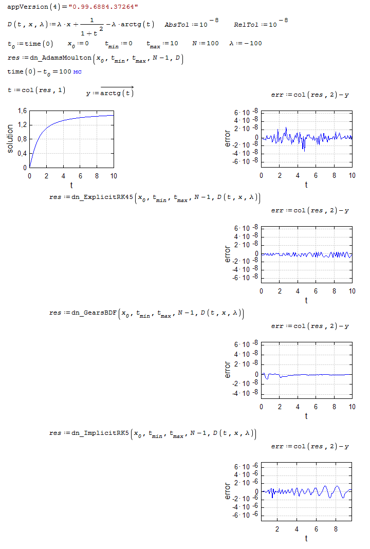

#31 Posted: 8/21/2022 2:43:28 AM
1,125 likes in 1,798 posts.
Hi Viacheslav. There are an issue with Implicit and dn_ExplicitRK45, just in the first element. Please see the attached.
dn_ExplicitRK45 issue.sm (8.42 KiB) downloaded 1663 time(s).
Вячеслав Мезенцев 8/22/2022 3:11:00 AM
#32 Posted: 8/22/2022 3:12:45 AM
SMath Studio compatibility
Plugin updated.
Changes:
- fixed values of initial conditions in the output array for dn_ImplicitRK5() and dn_ExplicitRK45().
sergio 8/22/2022 4:19:00 AM, Alvaro 8/23/2022 8:15:00 PM
