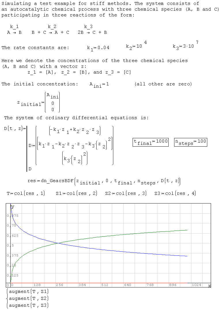

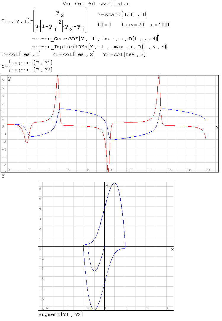

Differential Equations. Initial-value problem for nonstiff and stiff ordinary differential equations ODEs (explicit Runge-Kutta, implicit Runge-Kutta, Gear’s BDF and Adams-Moulton).
Solvers for Non-Stiff Systems:
dn_AdamsMoulton(init, x1, x2, intvls, D) solves an initial-value problem for nonstiff ordinary differential equations using the Adams-Moulton method.
dn_ExplicitRK45(init, x1, x2, intvls, D) solves an initial-value problem for nonstiff ordinary differential equations using the explicit Runge-Kutta method of order (4)5.
Solvers for Stiff Systems:
dn_ImplicitRK5(init, x1, x2, intvls, D) solves an initial-value problem for stiff ordinary differential equations using the implicit Runge-Kutta method of order 5.
dn_GearsBDF(init, x1, x2, intvls, D) solves an initial-value problem for stiff ordinary differential equations using the Gear’s BDF method.

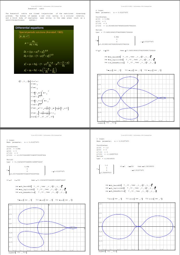

2. Arenstorf orbit. Numerical Analysis: Theory and Applications. Proseminar, 28.03.2011, UIBK [pdf].

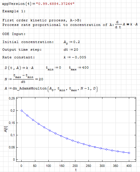

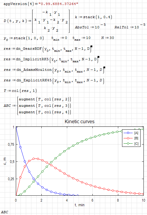

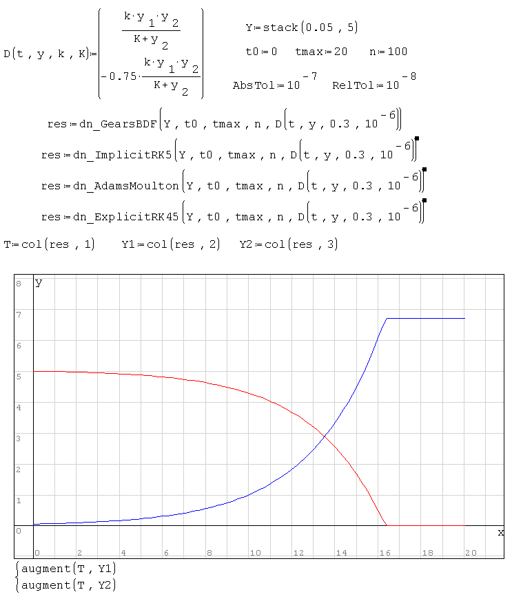

Examples:

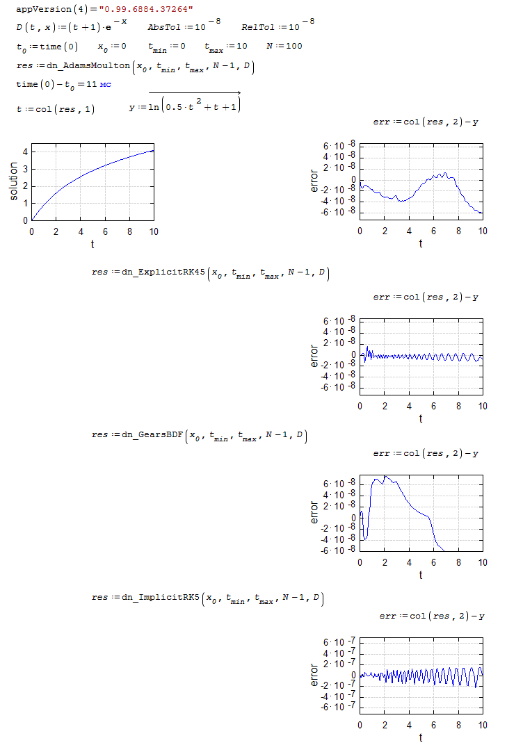

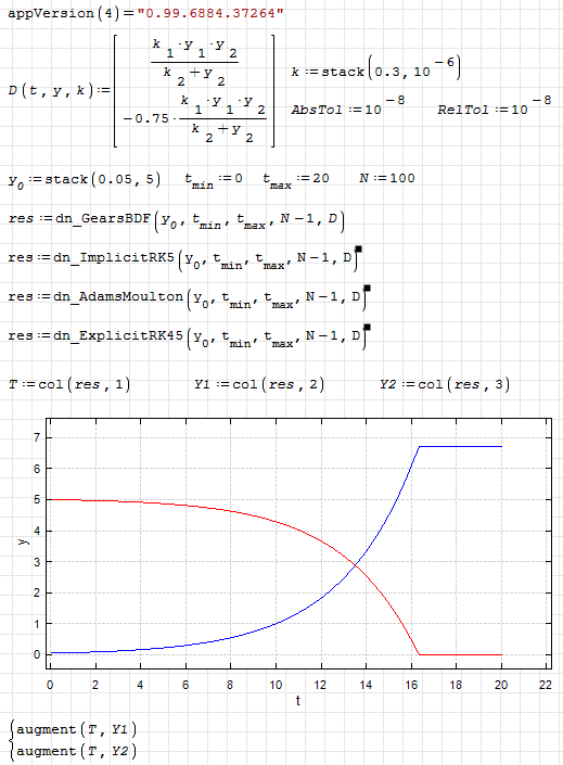

Test_GearsBDF.png DotNumerics. Example 3.png DotNumerics. Example 4.png Arenstorf orbit.JPG
2018-12-24_17-06-48.png 2018-12-25_04-33-23.png 2018-12-25_04-34-24.png dn.ode.test2.png dn.ode.test1.png 2018-12-24_17-07-41.png
dn.ode.kinetic1.sm (8.26 KiB) downloaded 2022 time(s).
dn.ode.kinetic2.sm (12.59 KiB) downloaded 1888 time(s).
dn.ode.kinetic3.sm (12.28 KiB) downloaded 1966 time(s).
dn.ode.test1.sm (19.58 KiB) downloaded 1969 time(s).
dn.ode.test2.sm (18.88 KiB) downloaded 1946 time(s).
dn.ode.Amplitude detector.sm (20.17 KiB) downloaded 1995 time(s).
dn.ode.kinetic1.pdf (77.42 KiB) downloaded 1114 time(s).
dn.ode.kinetic2.pdf (93.05 KiB) downloaded 1043 time(s).
dn.ode.kinetic3.pdf (91.31 KiB) downloaded 1032 time(s).
dn.ode.test1.pdf (115.72 KiB) downloaded 1016 time(s).
dn.ode.test2.pdf (120.44 KiB) downloaded 998 time(s).
dn.ode.Amplitude detector.pdf (148.87 KiB) downloaded 1052 time(s).

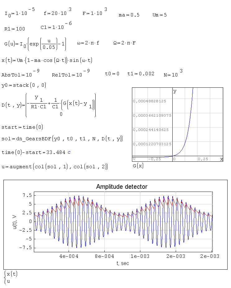

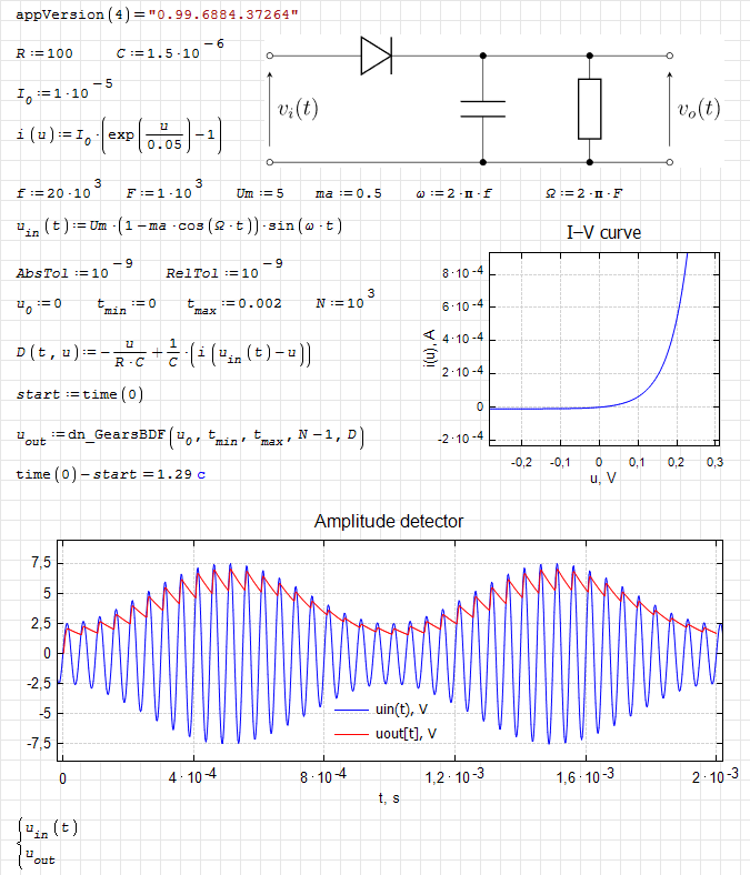

Amplitude detector.
Amplitude detector.sm (14.41 KiB) downloaded 1742 time(s).

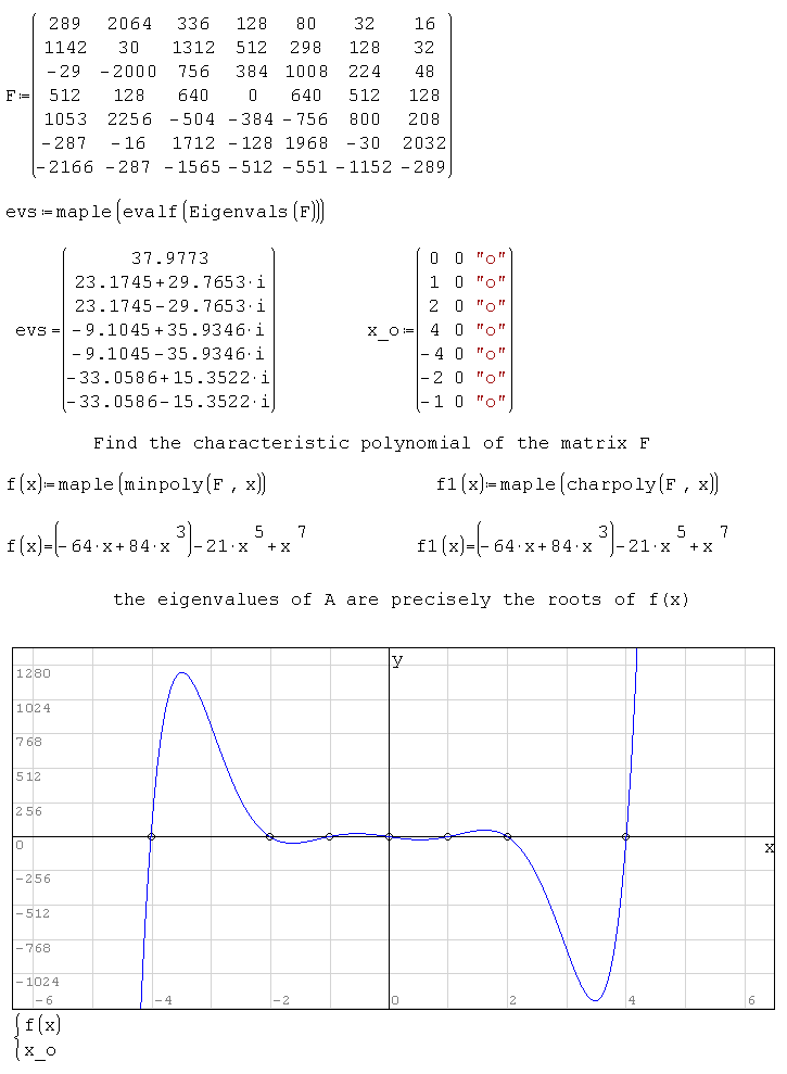

I'm not sure that dn_LinAlgEigenvalues() works correctly.
DotNumerics. Linear Algebra. Example 1.sm (28.95 KiB) downloaded 1827 time(s).
ioan92 7/19/2013 1:23:00 PM, Radovan Omorjan 7/19/2013 1:25:00 AM
#16 Posted: 7/19/2013 1:40:19 AM
Hello uni,
I played a bit with your example. It seems to me that eigenvalues and eigenvectors are correct for both matrices A and F. For the matrice F you gave the vector of eigenvalues which should be correct ("must be" vector). It seems that both vectors of eigenvalues - this one and the one found by dn_LinAlgEigenvalues() correspond to the eigenvectors fond by dn_LinAlgEigenvectors(). I am not sure this should be all right then or some numerical "glitch" is involved here. For some simpler matrices it works Ok and we can get the desired result by simple transformations of eigenvectors. I do not know how the AlgLib works and which kind of transformtion uses in order to give one of the many possible solutions for eigenvectors. I might be wrong about all of this, of course.
This time again eval() must be used as well to get the result. Moreover, again the well known annoying thing that sometimes the results with and without eval() are slightly different. See the attached file please.
DotNumerics_LinearAlgebra_Example-corr.sm (106.57 KiB) downloaded 1809 time(s).

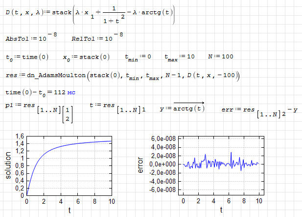

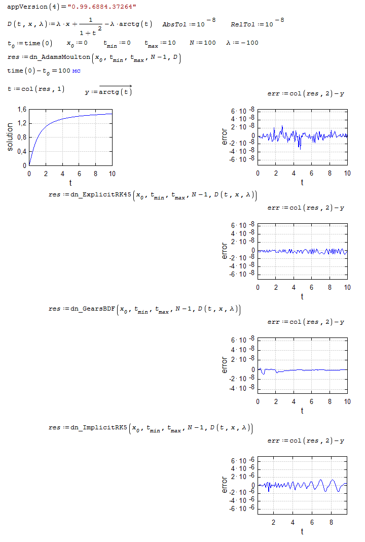

dn_AdamsMoulton simple test 1.
dn_AdamsMoulton.test1.sm (11.33 KiB) downloaded 1760 time(s).
dn_AdamsMoulton.test1.pdf (48.2 KiB) downloaded 887 time(s).
