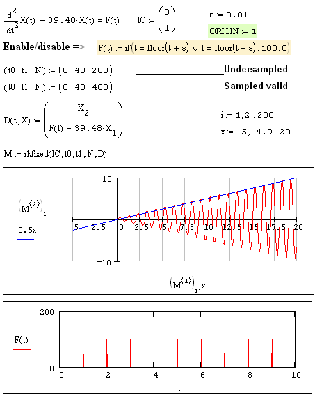

Simple test 2.

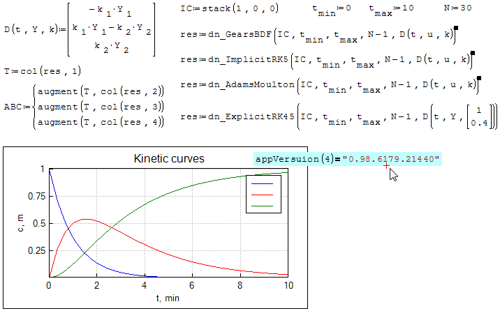

WroteSimple test 2.
Works nice conventional/visual [6179].
That document, if it would come from other designer
would pass my QA [Quality Assurance].
DotNumerics.ode.test2.sm (24,51 КиБ) скачан 1866 раз(а).

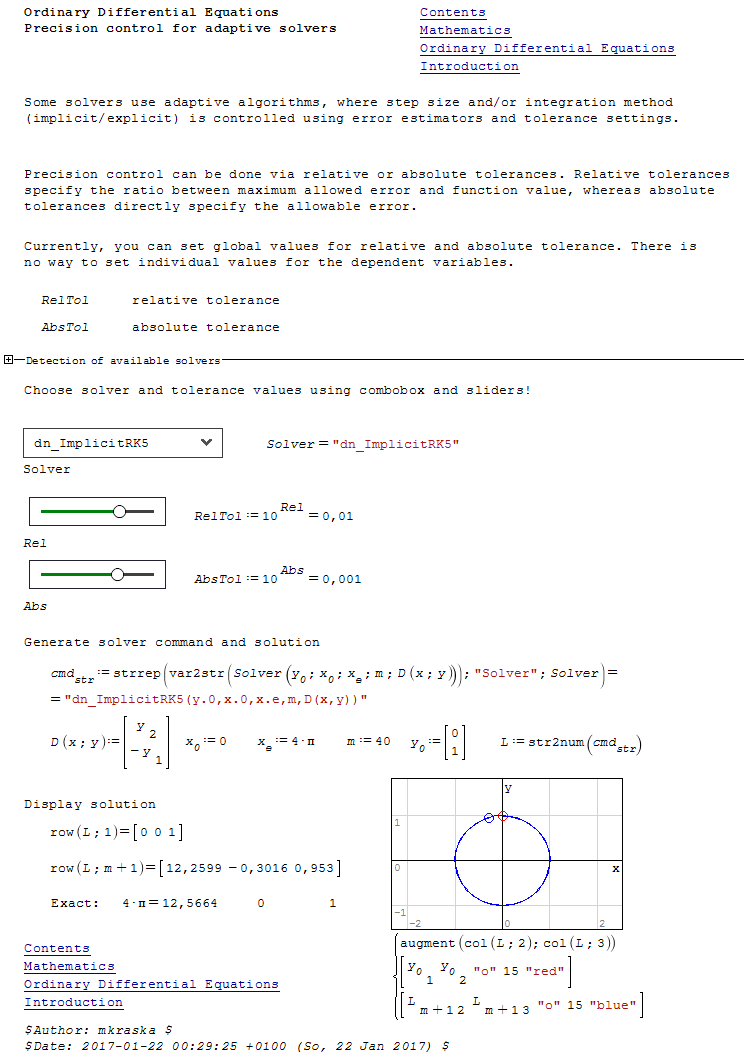

It seems that all the dotnumeric ode solver functions fail to add the last step to the solution. In the given example, the exact solution is (approximately) met if the end value of x is increased by one step (x_end/steps).
The sheet is easily extended to whatever ode solvers by adding their name to the search list. The actually available solvers depend on what plugins are installed.
Section Math ODE precision.sm (23,66 КиБ) скачан 1921 раз(а).
Updated for SS 0.99.6824. Intervals issue fixed.

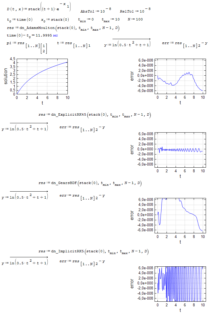

Hi Viacheslav. There are an issue with Implicit and dn_ExplicitRK45, just in the first element. Please see the attached.
