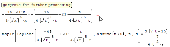

Василий Николаевич Храмушин
Пожалуйста поправьте ошибку, появившуюся после версии 097-5890
#2 Опубликовано: 05.04.2016 08:24:49

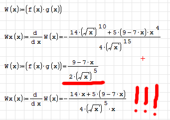

Mike Kaganski
Mike Kaganski
ЧЯДНТ?
Actually, I see another strange thing, that nevertheless, doesn't change results: If I show result immediately on assignment, following derivative optimizes differently.
С уважением, Михаил Каганский

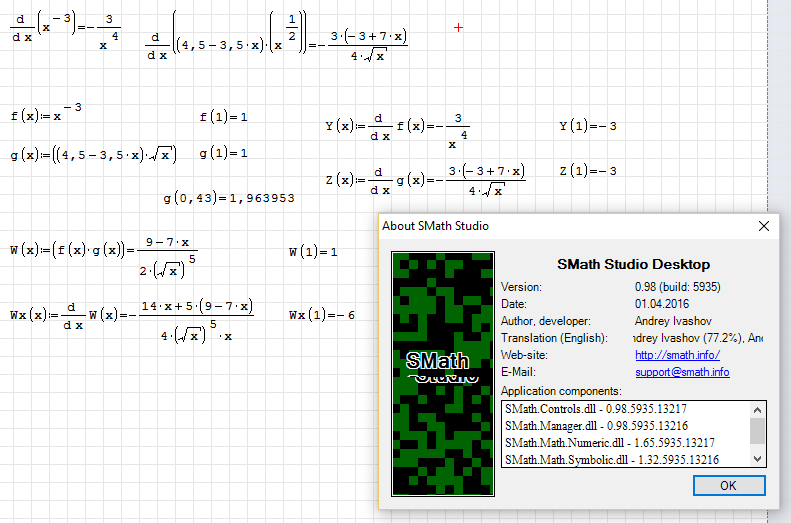

#3 Опубликовано: 05.04.2016 12:07:16
Alexander O. Melnik
Alexander O. Melnik
Прикрепи .SM файл с ошибкой к сообщению... Видишь, у Михаила все работает и сложно разобраться что к чему (то есть в проге ли ошибка или в твоем документе)

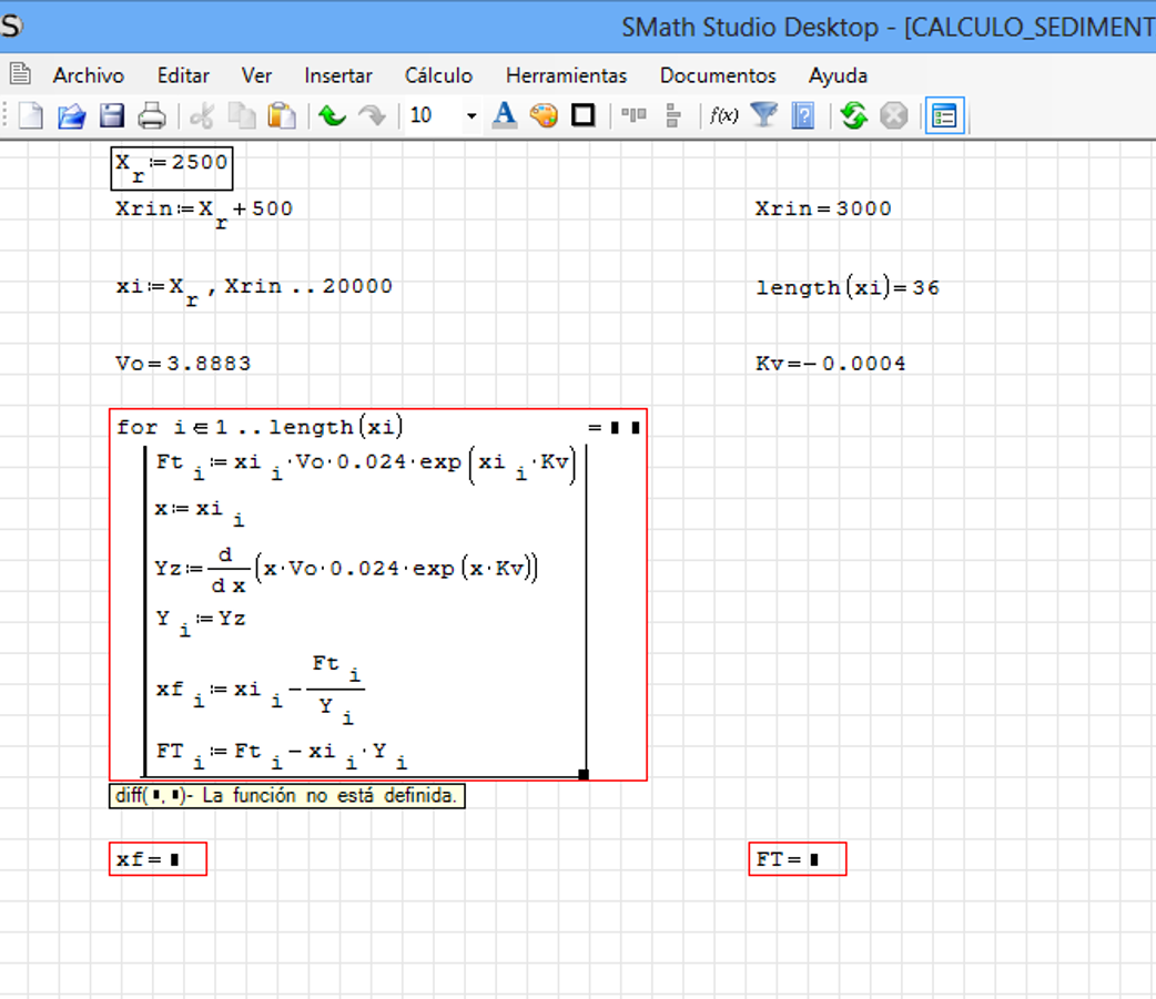

CBG
CBG

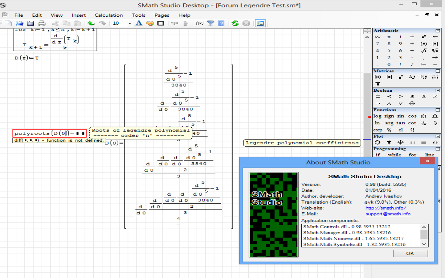

In the new version of Smath Studio ( 0.98 5935 ) , the "diff" function does not work properly, and gives the following error : diff () function is not defined.
#6 Опубликовано: 06.04.2016 01:04:15
Mike Kaganski
Mike Kaganski
Could you guys please check if a plugin causes that? Does disabling plugins solve the problem?

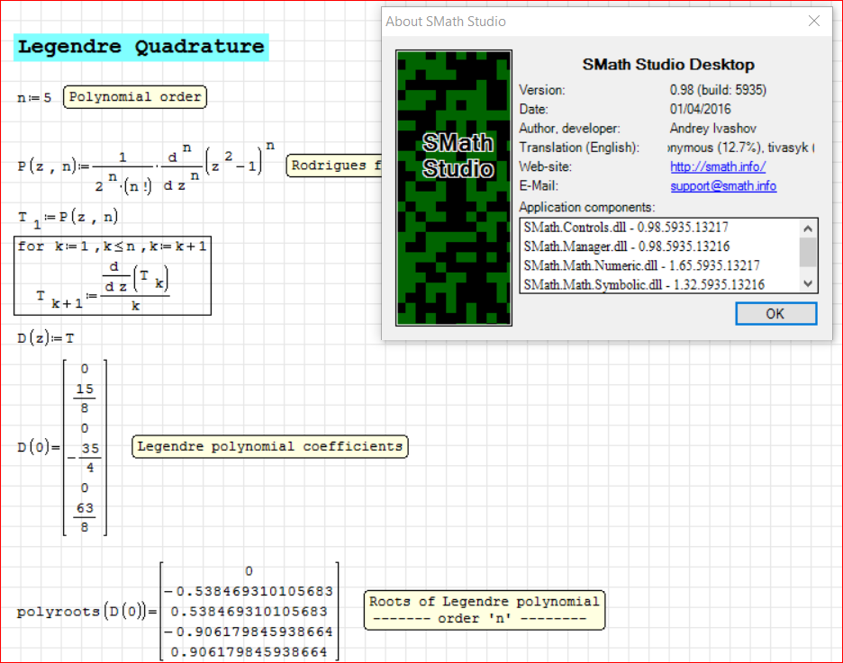

#12 Опубликовано: 06.04.2016 12:49:09
CBG
CBG
Jeand Giraud:
Your "Forum Legendre Test.sm", file does not work correctly in the current version of SMath Studio that I have installed.
#13 Опубликовано: 06.04.2016 13:01:12
CBG
CBG
mikekaganki : I disable all plugins, and the problem persists .
It seems to be a bug in the new version
#14 Опубликовано: 06.04.2016 13:03:46

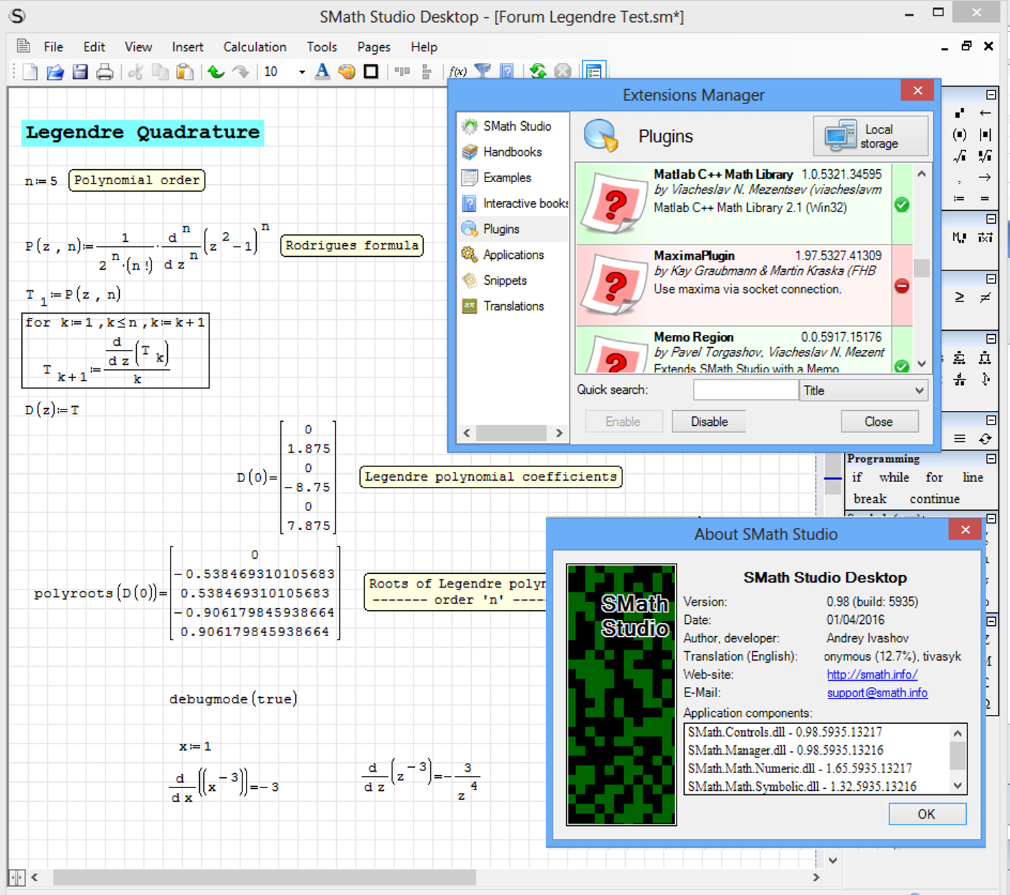

NDTM Amarasekera
NDTM Amarasekera
It works for me in SS 98.5935.
#15 Опубликовано: 06.04.2016 13:04:08
Thanks "CBG" for reporting. In Smath 5346 it does not go further than order 5,
it might ... but next century ! I was wise to tabulate "wr" the wi & roots.
So you can experiment. I have it otherwise from Mathcad but Smath does not
directly extract the coefficients for polyroots. If you are interested, in
that stuff, please let me know and see how we can collaborate.
I you read my just posted message "Install Smath 5935"
can you why I shit in my pants
Cheers, Jean

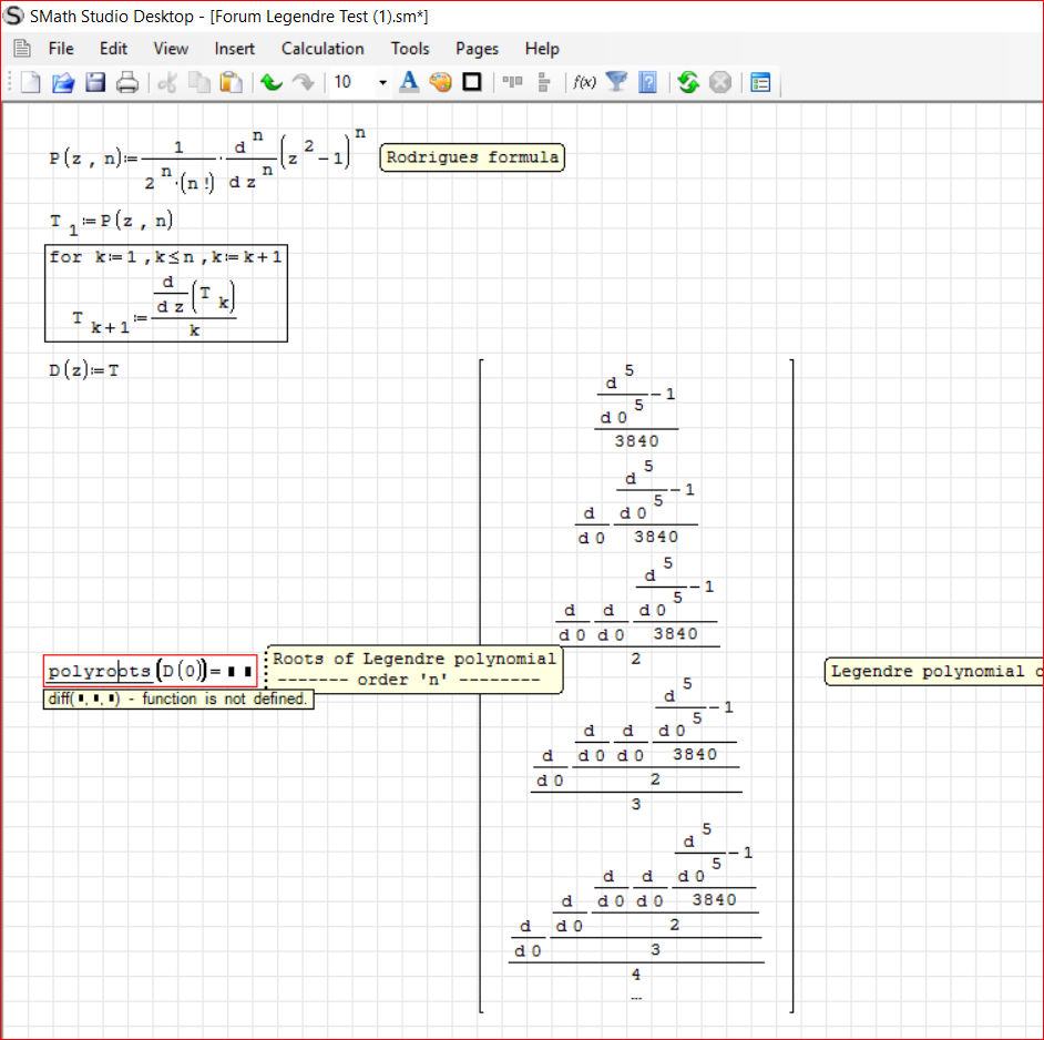

NDTM Amarasekera
NDTM Amarasekera
Hi Jean,
Thanks.
The culprit is the Maxima plugin. We have to delete this plug in to get your program to run correctly.
If the plugin is disabled and then re-calculated, the program will run correct.
However, disabling is not effective, as the error will re-appear when the program is reloaded.
The error is reproduced below.

CBG
CBG
I found the fault, this is caused by the Maxima Plugin.
I Disable it , and Smath Studio works perfectly .
Mikekaganki was right .
Thanks and regards
to all
CBG
