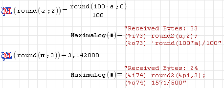

- MaximaLog(): Improved formatting

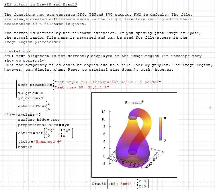

- Unicode support
- Draw2D/3D: PDF output support
Due to severe limitations of the current SMath beta (importData() not working) I shall focus on retrofitting the plugin version for the current stable SMath release 0.98.6179.

- Draw2D() and Draw3D() now can produce PDF vector graphics
and have consistent size control with length units or pixels
- Settings dialog streamlined

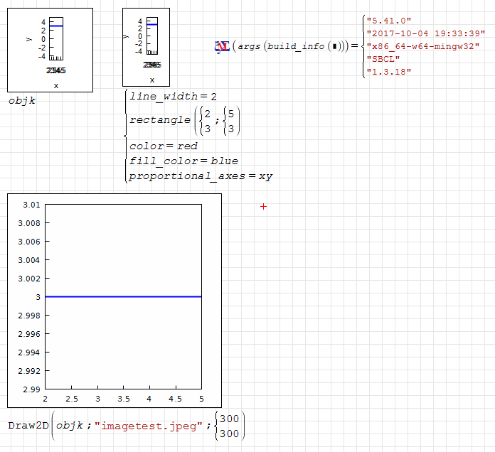

#232 Опубликовано: 22.02.2018 11:44:47
João Felipe Seráfico Melo
7 сообщений из 62 понравились пользователям.

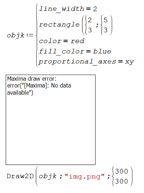

Hi!
I'm new to SMath and just started with Maxima. I'm more interested in its drawing functions.
I downloaded version 5.38.1 and set the path. It starts correctly, but drawing commands keep not working.
For example:
And the log shows:
draw2d([background_color="#fefefe",file_name="C:/Users/João Felipe/AppData/Roaming/SMath/extensions/plugins/44011c1e-5d0d-4533-8e68-e32b5badce41/GnuPlot/ieaglqnv",terminal=png,user_preamble=["set term pngcairo font ',8' enhanced size 300,300","set encoding utf8"],line_width=2,rectangle([2,3],[5,3]),color=red,fill_color=blue,proportional_axes=xy]);draw2d(terminal=pngcairo, file_name="C:/Users/João Felipe/AppData/Roaming/SMath/extensions/plugins/44011c1e-5d0d-4533-8e68-e32b5badce41/GnuPlot/z4ujxmcs", dimensions=[250,250], font="Arial", font_size=8, title="SAMPLE PLOT", xu_grid=40, yv_grid=40, xlabel="x", ylabel="y", zlabel="z", yrange=[-5,5], zrange=[-5,5],user_preamble=["set term pngcairo font ',8' enhanced size 250, 250", "set encoding utf8", "set grid xtics mxtics"],explicit(sin(x),x,-5,5));
I would appreciate any help.
Thanks in advance!
#233 Опубликовано: 22.02.2018 12:47:22

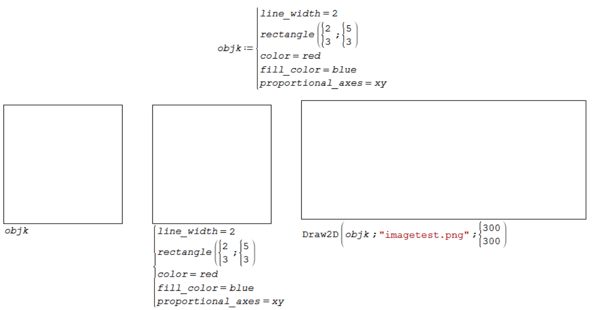

There are two ways to display Maxima graphics.
1. Use a dedicated interactive Draw region (Insert> Maxima> Draw2D()/Draw3D()) and write the list of draw objects and settings to the placeholder.
2. Use an image region (Insert> Image) and write a Draw2D/3D function with appropriate arguments to the placeholder. These functions generate graphics files and return the name of the file. This is what Image region needs to display the image.
You mixed both approaches. Thus either put objk in the placeholder of the maxima region or put the full Draw2D command in the placeholder of an image region.
I didn't test 5.38.1 with the current plugin version (don't know if that Maxima is unicode-proof). I recommend 5.41.0.
#234 Опубликовано: 22.02.2018 13:04:32
#235 Опубликовано: 22.02.2018 13:10:16

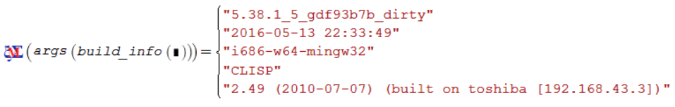

please attach your sm file and give the output of Maxima(args(build_info(#)))
#236 Опубликовано: 22.02.2018 13:11:28
#237 Опубликовано: 22.02.2018 13:24:03
.sm file: testing_drawing2d.sm (14,53 КиБ) скачан 1674 раз(а).
#238 Опубликовано: 22.02.2018 13:33:52
Works for me. Not really exciting because the rectangle is just a horizontal line but works.
Your maxima is outdated and not set to steel bank common lisp (SBCL). If you really need to work with old maxima, then you might try the 2014 version of my portable distribution, follow the link in my signature.
