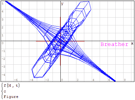

#20 Posted: 8/2/2016 3:22:02 PM
Thanks Ber7 for your repost/new animations. Some don't work in Smath 5346,
so what. Animation is a very nice feature from Smath.
Rotate XY.sm (474 KiB) downloaded 1677 time(s).
