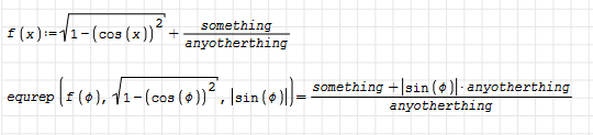

is this solution correct?
question_230609.sm (3.75 KiB) downloaded 1381 time(s).

Obviously not, but the bug isn't that obvious: just avoid to use that 'phi' (j Ctrl-G):

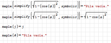

Is it only valid for Windows?
Linux mono doesn't have this problem.

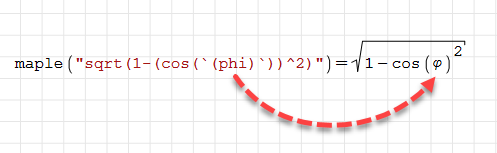

Yes, these are different letters:
cos(ϕ) and cos(φ)
maple() works with φ
This was done to unambiguously convert variables into Greek letters:
maple() function uses implicit encoding of Greek letters:

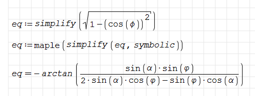

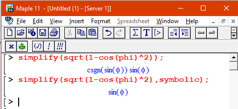

I think the result soomoon expects is this, but it requires a newer version of maple:

Inside SMath, you can't. This is a workaround, valid for real values
