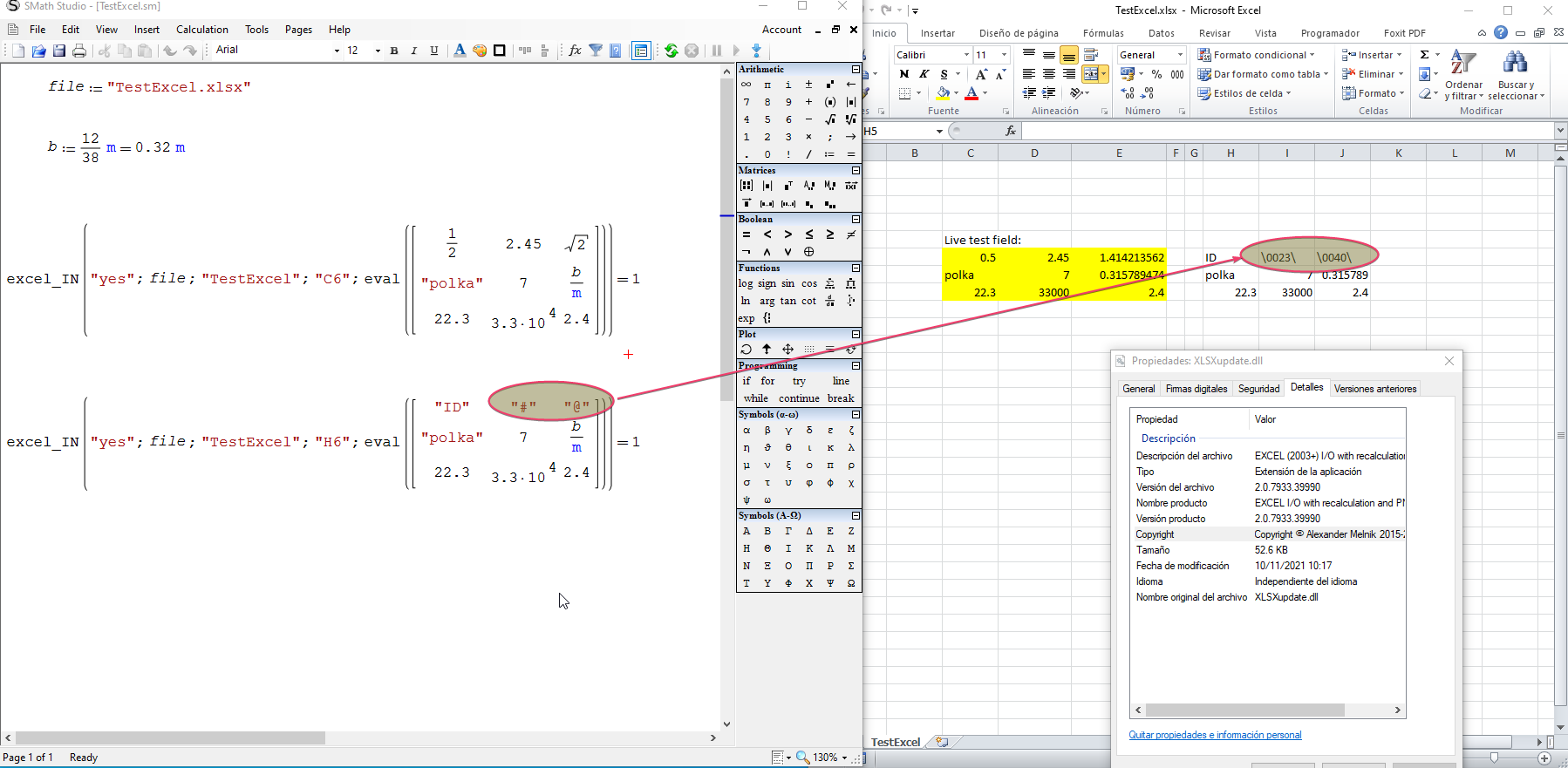

Hi! I'm having trouble sending String variables to Excel.
For instance, ". - / ! ? ;" turns into \002E\\0020\\002D\\0020\\002F\\0020\\0021\\0020\\003F\\0020\\003B\ in Excel.
I'm using most recent SMath and Excel I/O versions.
#108 Posted: 11/1/2021 10:05:32 AM
Ricardo_Herrera
Ricardo_Herrera
1 likes in 8 posts.
Hello, good morning, could I send a screenshot to see the error that generates a hug from a distance
Rikardo21

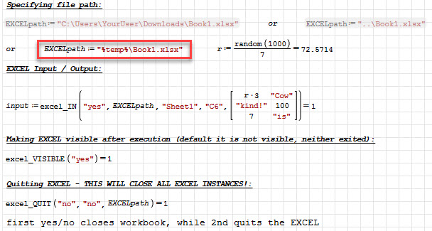

#114 Posted: 7/3/2022 6:10:06 AM
1,558 likes in 1,868 posts.
You can use operating system environment variables in the file path.
4 users liked this post
NDTM Amarasekera 7/3/2022 8:00:00 AM, churichuro 7/3/2022 12:59:00 PM, Alvaro 7/3/2022 3:51:00 PM, oscar mauricio 7/7/2022 11:37:00 AM

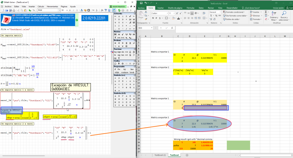

Hello thanks for the plugin, I found a problem in the excel_In() command. I present it in the image, I hope it can be resolved in future versions.
#116 Posted: 7/8/2022 4:45:19 AM
SMath Studio compatibility
Plugin updated. Please try.
Changes:
- ToCell(): Globals.Excel.DecimalSeparator replaced by the CultureInfo.GetCultureInfo( "en-EN" ).NumberFormat.NumberDecimalSeparator;
- ToCell(): Double.Parse() fixed;
- part of the book "Excel 2002 VBA Programmer's Reference" added (Chapter 22. International Issues).
Click to enlarge

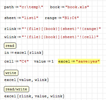

It is possible to simplify the interface. I can add a new feature. You can suggest your own version for a new feature.
#118 Posted: 7/9/2022 6:43:56 AM
In a future release I will remove functions from ExcelIOCom to XLSXupdate. One function and one operand will be added.

#119 Posted: 7/9/2022 12:41:31 PM
SMath Studio compatibility Examples
Changes:
- excel operand and excel() function added;
- readCell() and writeCell() moved from the ExcelIOCom plugin;
- examples added;
- refactored.
