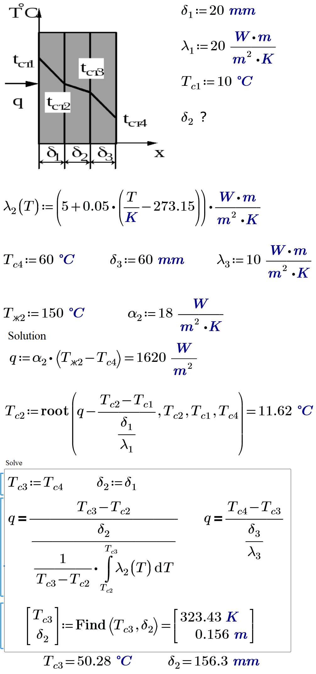

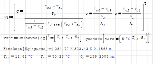

I can it solve in Mathcad - see please mcdx and pdf files
I try solve it (heat transfer) in SMath - see sm file
Help please
File not found.File not found.File not found.

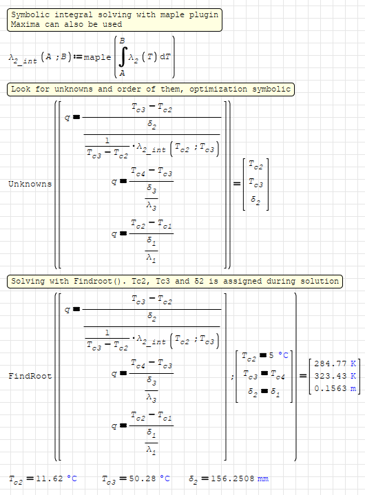

#2 Posted: 6/3/2023 3:37:44 PM
600 likes in 1,381 posts.
Help please
SMath symbolic solving of integration is not capable as Mathcad.
Thus integrals can't be used with numeric solvers.
However, you can use a little trick to solve them.
Using maple or maxima plugins is the key.
Here is your problem solved with various ways, roots() and Findroot().
solvewithunits.sm (23.4 KiB) downloaded 1447 time(s).
3 users liked this post
Valery Ochkov 6/3/2023 3:53:00 PM, sergio 6/4/2023 1:03:00 PM, NDTM Amarasekera 6/4/2023 3:15:00 AM

#4 Posted: 6/4/2023 10:00:56 AM
Actually, you don't need to find Tc2 first hand.
Findroot() can solve with all three equations at once.
All important is the order of unknowns.
Valery Ochkov 6/4/2023 12:03:00 PM, sergio 6/4/2023 1:48:00 PM
#5 Posted: 6/5/2023 12:08:21 AM
Here is a paper-friendly version.
Also check how variable guess points are assigned.
Valery Ochkov 6/5/2023 2:23:00 AM

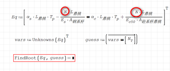

#9 Posted: 6/26/2023 2:33:01 AM
netsonicyxf
netsonicyxf
2 likes in 79 posts.
Please help, why can't find root for this simple equation?
root.sm (20.2 KiB) downloaded 1412 time(s).

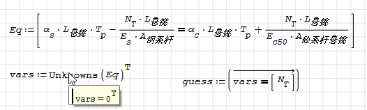

#10 Posted: 6/26/2023 5:54:06 AM
Because there aren't unknows

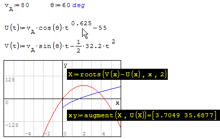

#11 Posted: 6/26/2023 8:45:01 AM
Please help,
why can't find root for this simple equation ?
roots solves wrt scalar function(s)
In this example, both functions are scalar wrt 'x'.
Try ... roots[(sin(x)-Gamma(x),x,1]
'x not defined' ... Gamma(x) is not scalar wrt 'x'
Few more numerical functions are not scalar
erf(x), erf(x,n) ... erfc(x), erfc(x,n) ...
#12 Posted: 6/26/2023 8:55:02 AM
In that case and similar ones,
RootSecant algorithm will spits out 15 decimals, instantaneous.
Cheers ... Jean.
#13 Posted: 6/26/2023 10:06:59 AM
netsonicyxf
netsonicyxf
Thanks Davide.
Now I put "N" as unknown in the Eq. But it can't be solved either.
root.sm (19.41 KiB) downloaded 1376 time(s).

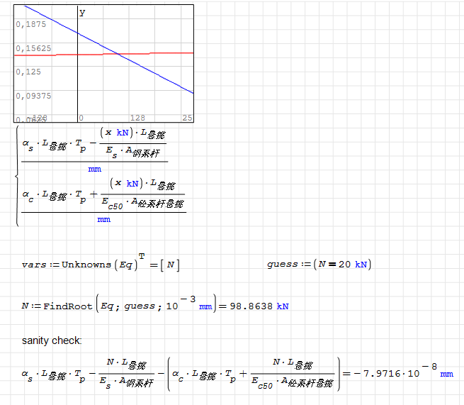

#14 Posted: 6/26/2023 10:58:58 AM
You have to play a little with the precision, especially if there are units involved; in this case, seems that 10^-3 mm is a stable target (10^-2 works too, but in some case it returns the guess value, meaning that is "close enough" for the algorithm - you can see in the plot that 0kN to 200kN is in +0.02/-0.02mm range)
root_r1.sm (24.03 KiB) downloaded 1444 time(s).
netsonicyxf 6/26/2023 12:18:00 PM
