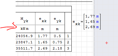

As shown in the attached image, I encounter a problem using SMath-formatted labels for table headers.
This problem did not exist in previous versions as highlighted in the image.
In particular, the problem seems to be limited to the use of "." for the subscript.
I note that the opening "TableRegion.sm" of the sample file causes the program to crash Smath (only in version 098.6356).
[albumimg]1457[/albumimg]
Davide Carpi 05.07.2017 09:34:00
#46 Опубликовано: 05.07.2017 13:28:14
Thank you Sergio,
please try with the updated plugin
sergio 05.07.2017 14:55:00

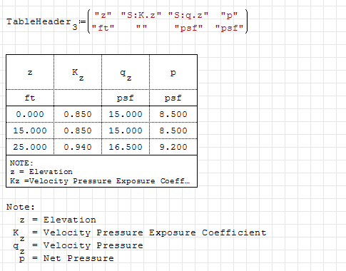

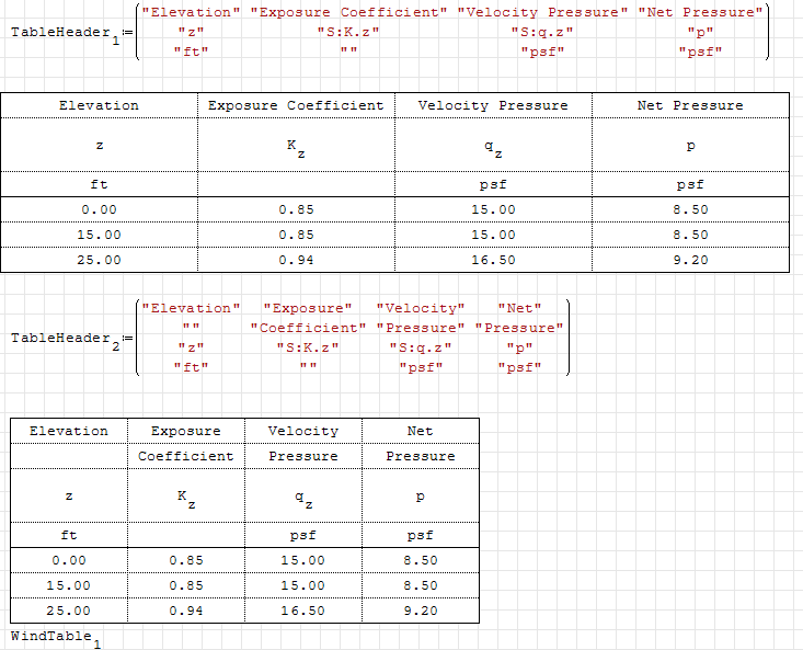

Davide,
I looked through the example files but I didn't see anything that addressed my situation.
I'm not sure if this is even possible or if I overlooked the option.

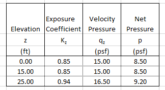

Is there a way to word wrap the header to fit a set width for the numeric table values?
The second table in the screenshot is similar to what I'm trying to achieve.
I also made a quick example in excel to help illustrate.
I was also going to use the footnote option as an alternative but I'm came across a similar problem where I couldn't widen the note section since it appears dependent on the table width.
#50 Опубликовано: 05.07.2017 21:26:15
Hello [userlink]uncblue[/userlink],
I guess this feature is not available (I have to double check the code but I'm almost sure I haven't ooded it).
This plugin has a lot of room for improvements (and several fixes), I'll try to come back on it in the future!
uncblue 05.07.2017 21:59:00

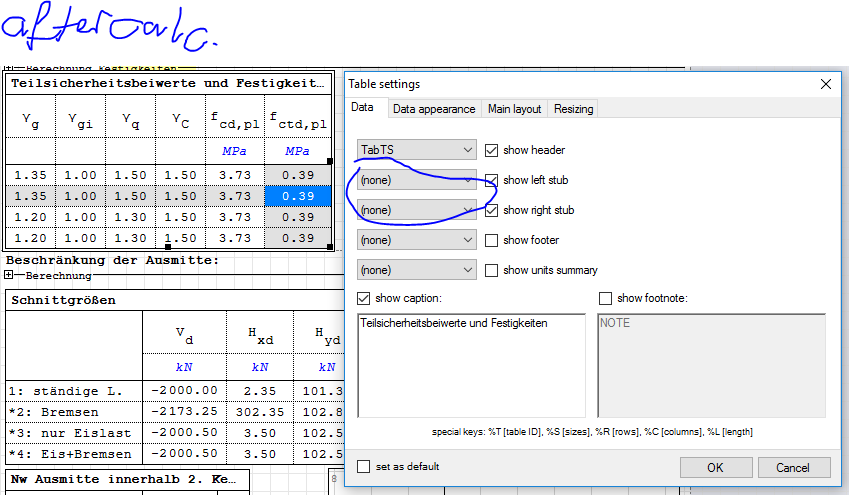

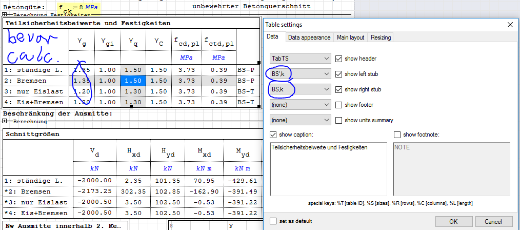

found an issue in Version 0.1.6395.15149, using SMath 0.98.64.84.
It is related to using commas (,) for decimal separator.
The plugin seems to replace every point with a comma, also where used as subsript.
e. g. "BS,k" (the string "BS,k" cannot be found in the sm-File).
Tables work well if point as decimal separator is used.
Bevor calculation:
After calculation:

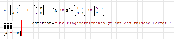

Nested arrays as input for a table don't work anymore, too.
#54 Опубликовано: 04.10.2017 12:11:38
Thank you [userlink]MarB[/userlink], I'll look into it ASAP

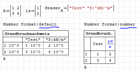

In following screenshot you can see the following behaviour:
With number format set to default...
- numbers are always written with exponent (left/right stub also)
- strings are printed with surrounding "" and Expressions are not formatted
By changing the number format to number, everything looks as usual.
Is that intended?
Davide Carpi 09.10.2017 04:14:00
#57 Опубликовано: 09.10.2017 04:27:01
Thank you,
it's a bug indeed, I'll fix it later today.

#58 Опубликовано: 10.10.2017 11:48:30
please try again now
